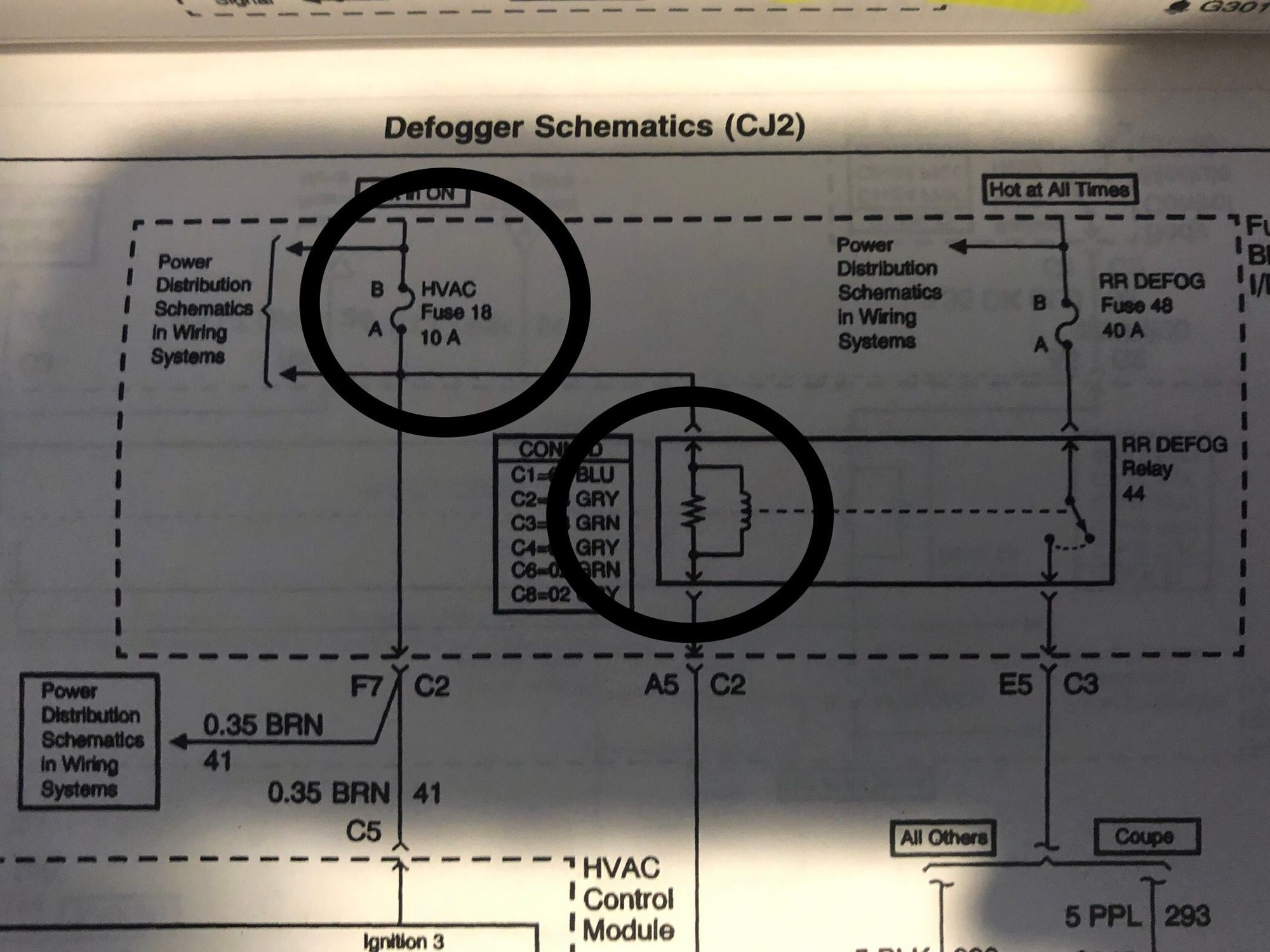

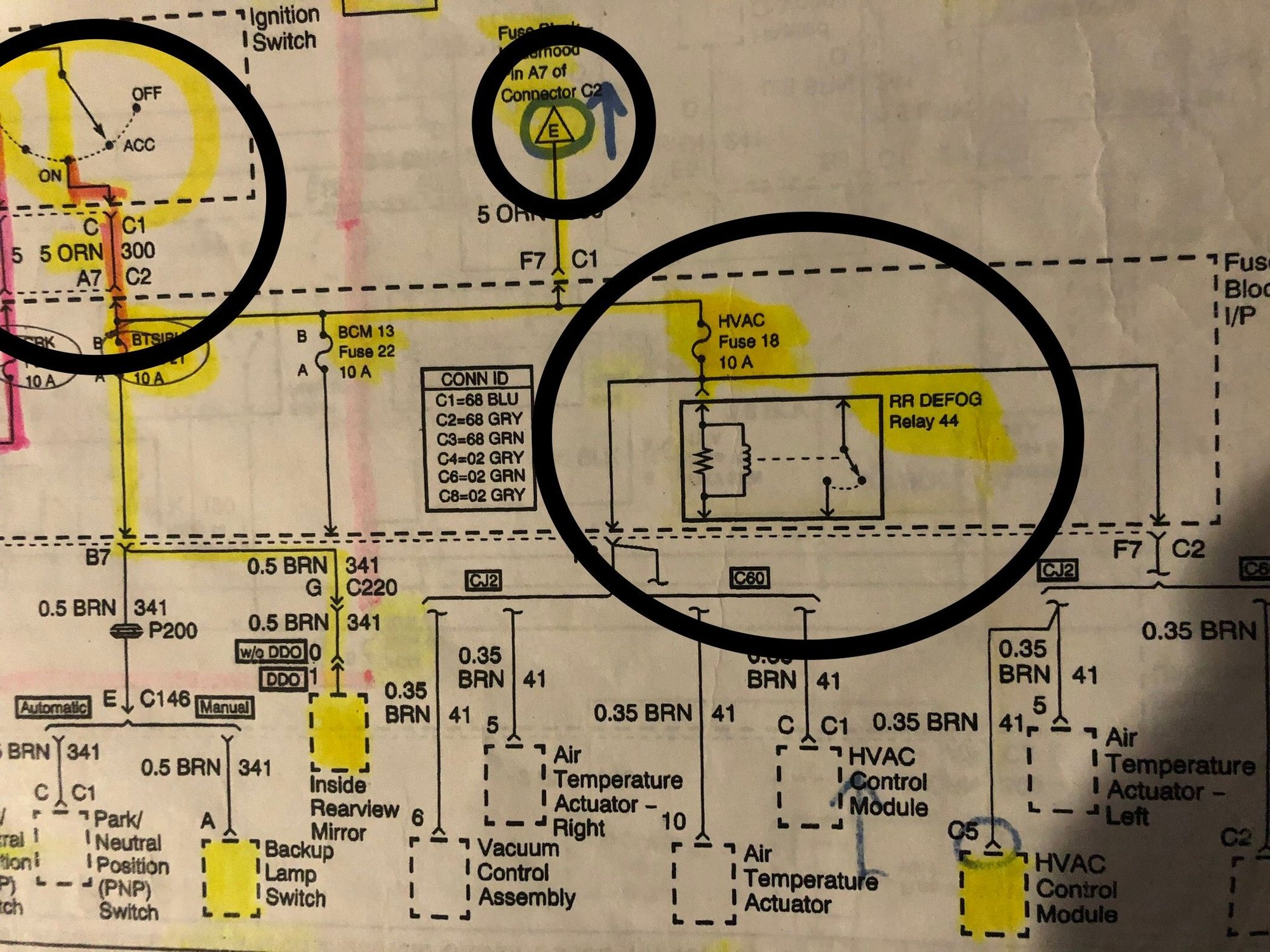

the only thing I can see is that all DTC’s....RR DEFOG, HVAC, and EBCM “may” be caused by ignition switch as you can see in the FSM from my 2001...not knowing your skill set I would do a voltage drop across the ignition switch to the HVAC fuse !!

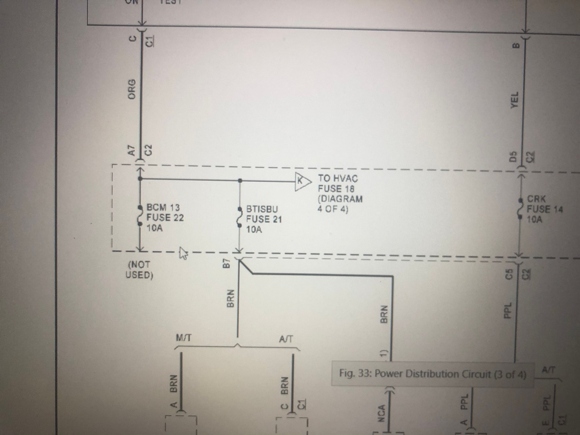

I looked at my Mitchell wiring diagram and it looks like fuse 22 goes nowhere !!...NOT USED !!

The BCM fuse is 23. Fuse 22 is blank

I just spent about 30 minutes and pulled the ignition switch. Gonna pick one up and replace to see if that solves any issues. Pulled the green cover and contacts look worn
