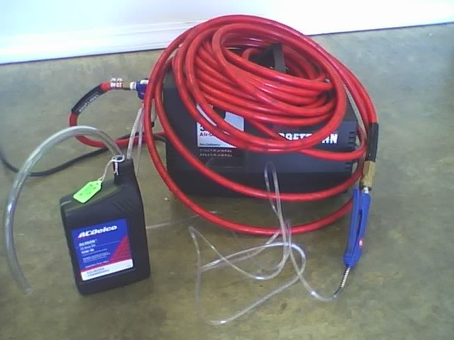

I would use the GM manual transmission fluid in the 6 speed. For me, it was a waste of time to try to use the manual pump that fits on the bottle.. It broke after only a couple of pumps, so I ran the fill tube through the cap to the bottom of the bottle, and ran a small tube to the top of the bottle from my air compressor through a nozzle to control the pressure. The air pushed the fluid up into the transmission in less than a minute... Just be careful not to over pressure the transmission fluid bottle...
