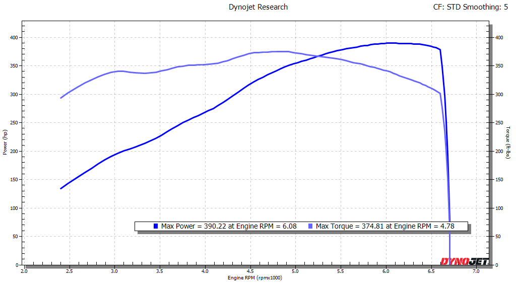

This is the Dyno from my 99 FRC with the LS1. Mods I have are FAST 92mm intake manifold, Ls2 throttle body, stock heads (853s), LG 1-3/4 long tubes, and Varam cold air intake. Got it tuned by Cicio performance.
