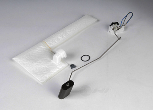

Originally Posted by RJVette23
......... but dealing with it until I feel like replacing the sending units.
Smart move. Driver side is replaceable as a separate unit. Passenger side only replaceable as entire siphon pump/sender assembly.
Driver's side: AC Delco SK1318 (GM part# 10333749) Includes new filter sock. Approx $80 to $85. Does NOT include new tank gasket.
You may be able to reuse your gasket and bolts, but be very careful when re-attaching the bolts. I don't have the correct torque in front of me, but the threads in the tank are brass. If you get a new gasket, it comes with all new bolts (usually with one spare also).
Gasket (same for both sides) AC Delco G25. Prices will be anywhere from $37 to $50, depending where you shop. That may seem high, but trust me, that's the going rate. That gasket is a special design and ONLY used on C5 Corvettes, due to the fuel tank design. Again, be SURE you do not over-torque those fasteners, and use the crisscross "star" pattern, much the same as tightening lug nuts.
To replace the right side, you need:
AC Delco MU1218 complete assembly, approx $260 to $300 depending where you buy, and should come with the new gasket. That second photo is also an ACDelco piece. Note the filter (wire mesh) is of a different design than the original, as well as the left tank. This is normal on the newer or replacement right side units.
The Bosch unit (part #67466) will save you a few bucks at $226.79 (rockauto), and also sold at Summit. No gasket with the Bosch I don't believe. Bosch is good quality. Carter and Airtex also make it as well.

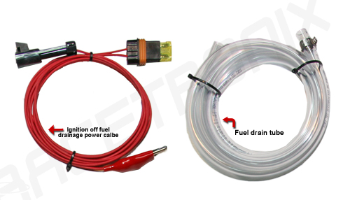

Default C5 fuel drain kit
Originally Posted by Jumper11
...........Got any insight on the best way to get the gas out of the RH tank?
www.racetronix.com/

Old Dec 4, 2013 | 10:20 PM
Gitusum's Avatar
Gitusum
Joined: Dec 2005
Posts: 6,460
Likes: 16
From: hamilton alabama
Originally Posted by LoneStarFRC
how will that work if the pump is needing to be replaced? hooking that up wont work if the pump is bad correct?

If the electric pump were dead yes, but then again if the "pump" was indeed dead, he couldn't drive the vehicle in the first place.
There's two pumps, one electric in the driver's side tank and one mechanical (called a siphon-jet pump) in the passenger side tank. The Racetronix unit speeds up fuel removal, but you can also remove the fuel cap and disconnect the appropriate line(s) at each tank and let it drain that way as well. If you remove the quick-connect line and quickly push a hose onto the nipple it helps direct the gas to a container for collection.
