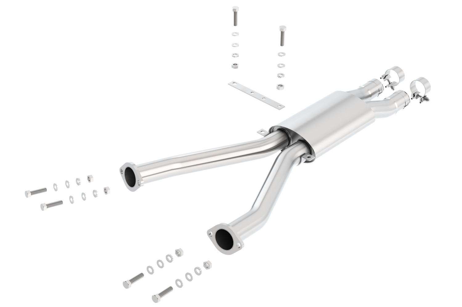

If you dont quite like how it sounds with the borla straight pipes, borla also makes a little add on piece to clean it up and tone it down a little. It is a small muffler with a "X" Built in to smooth out the sound. The "X" will clean up the sound and make it a little smoother less motor boaty sounding.
Borla 60061:

Thanks for clearing that up everyone. Now, to make sure I got this straight, I could get long tube headers, connected to the Borla xpipe with resonators, to the Borla axle back that I already have, correct? Cats deleted.
The Borla xpipe is just that right, a replacement xpipe but with resonators?
