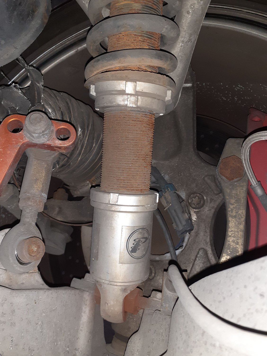

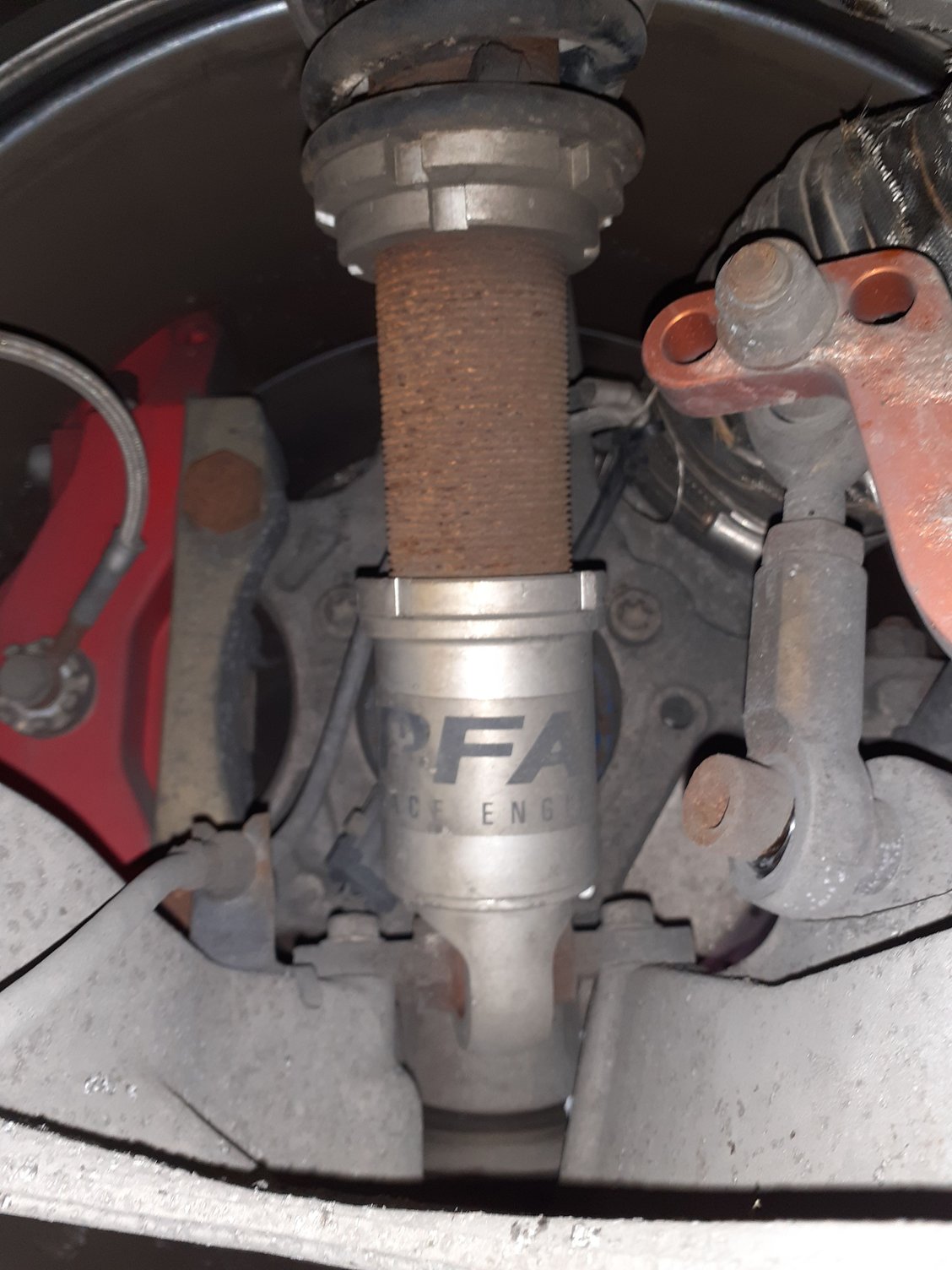

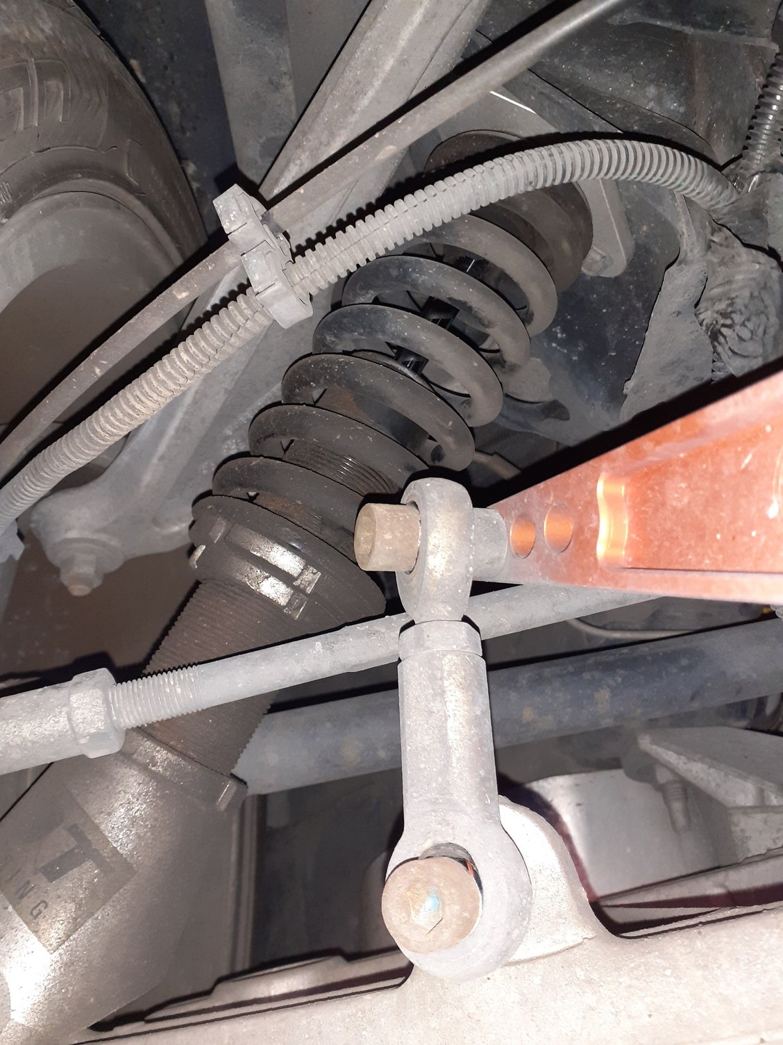

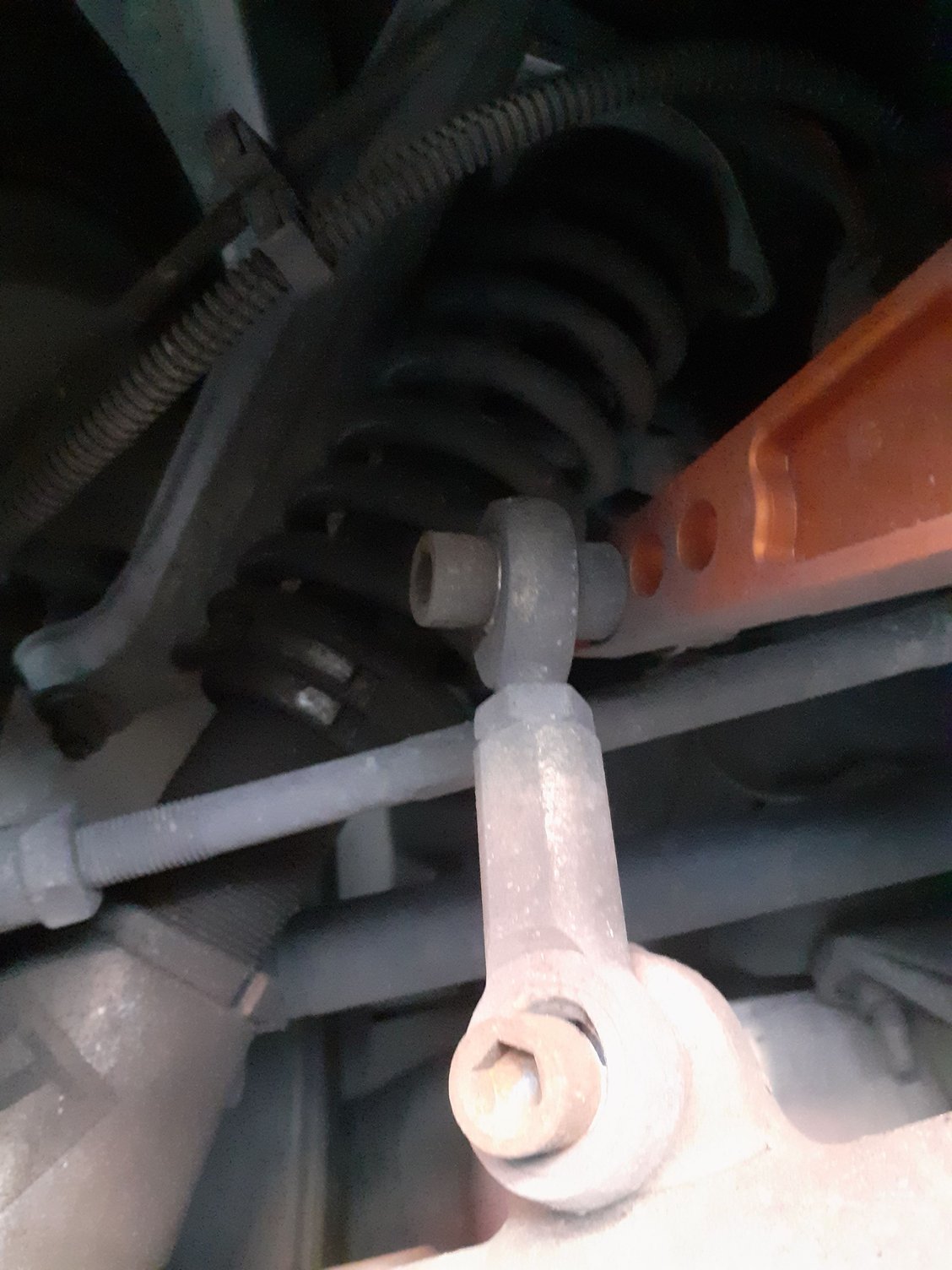

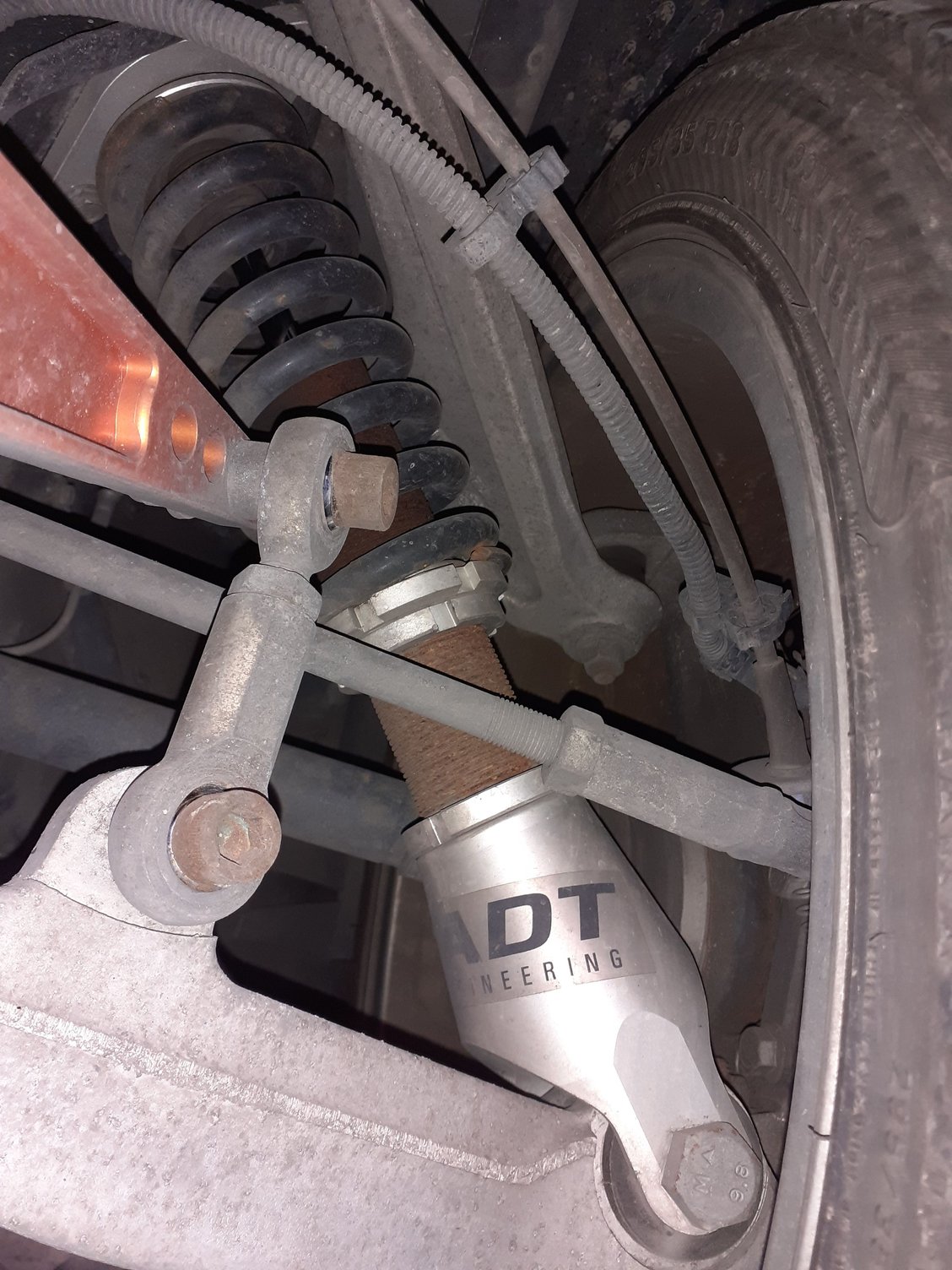

Hello fellow First Generation Pfadt coil-over owners..I had a set of coil overs and front and rear sway bars installed in my 2004 C5 Z06, but I've lost the instructions for it. Can anyone please scan a copy or provide me a link? I'll try aFe as well but wanted to ask here as well. Here are pics of my 15 year old Pfadts that are getting cleaned up now ..I am now only tending to my car after a long absence due to personal reasons. Photos are not for the squeamish
