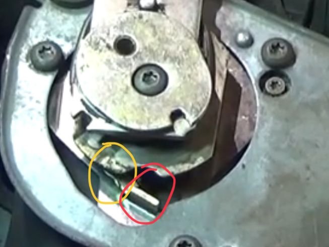

The tab circled in yellow on the lower moving plate, has to stop at the tab circled in red. It doesn’t reverse properly if they the tab doesn’t stop the lower plate. My tad didn’t look bent out of position, but I bent it forward and put it back together, and it solved the problem.
