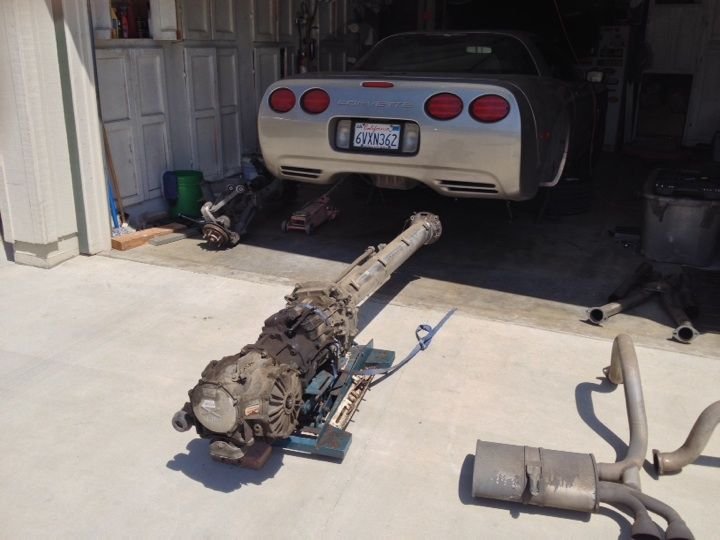

Its definitely a fun job lol. But completely doable. Just get it this high lol.
