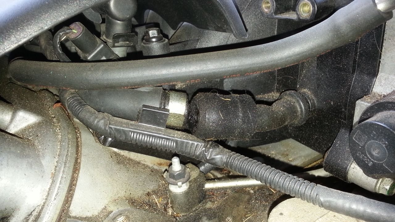

I think I have the same problem, and I believe it's this broken exhaust hose on the passenger side of the throttle body.
Broken exhaust tube to throttle body
What is this tube, and how do I tell a car parts place what I need to replace it?
Thanks,
Anthony

My friend,,,, That is a broken PCV rubber fitting and YES,, it will cause a NASTY idle issue, poor economy.. Your PCV system is also not working correctly.
If it were me,,,,,,, I would inspect every inch of that system. It has other rubber parts that can do the same thing. The plastic tubing can also split and leak.
Bill

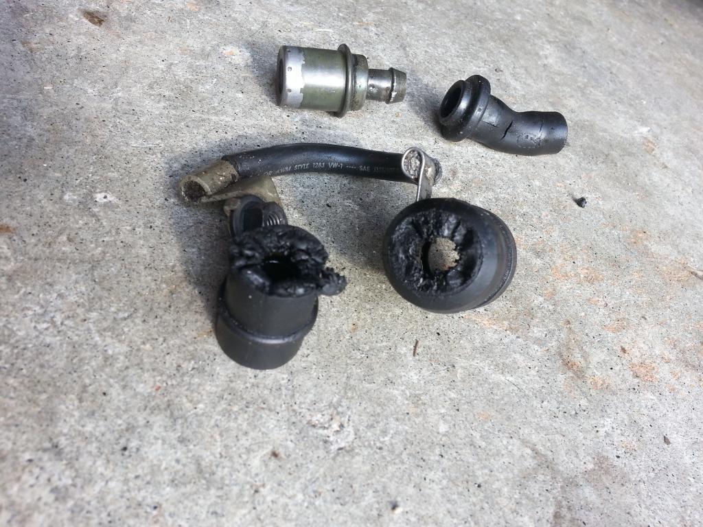

Here's the pics of the damaged/broken PCV valve connecting tubes. What part umbers are these? I figure I'll have to rig something to get me through the week til I can get 'em...
To idle issue
