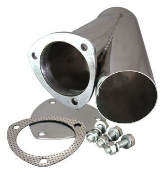

Sorry, I looked at the QTP cutouts and I still don't see how you are capping and uncapping.
The electric version is a baffle, correct?
I am assuming you do not install the baffle at all if you go the manual cap and uncap route, correct?
So, exactly how are you capping the pipe? Do you have a pic of this?

Its just a Y with one side goin to Ti mufflers and the other going to the air. The cap is just a plate covering the open exhaust hole. You take the entire plate off it doesn't rotate like electric.
Right. But exactly how is the plate attached? screws?
Is it a flat plate or shaped like a coffee can?

The setup I'm working on installing has the manual cutouts welded into the exhaust pipes before they go over the rear diff with plates that are secured by 2 bolts per plate. My shop will create a turndown for each plate with a flange that lines up with the bolt holes and can be changed out with the cover plate when I want to open up the exhaust and with a turn down that will direct the exhaust flow away from the transverse spring.

Im surprised you havent just looked it up, here's the basic idea:
To Cutouts or cutom Ti work
