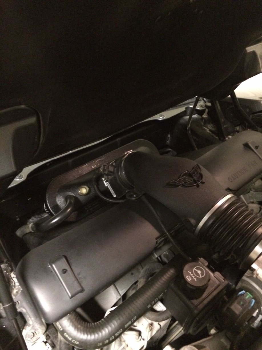

i just cleaned and re-oiled mine today (on my 2004 Coupe). If I took pictures of it... could you compare it some pics of the one for sale?
Like someone said earlier, there was a hole for a vacuum line (about 1" diameter) that simply inserts into the hole. And there was another cylindrical-shaped piece (that kinda looks like a "plug" of some sort just to the right of that (both on the driver's side).
I didn't measure the diameter of the MAF.
Here is a photo of mine (installed)......
And a close-up photo of the vacuum tube and the other widget.....
