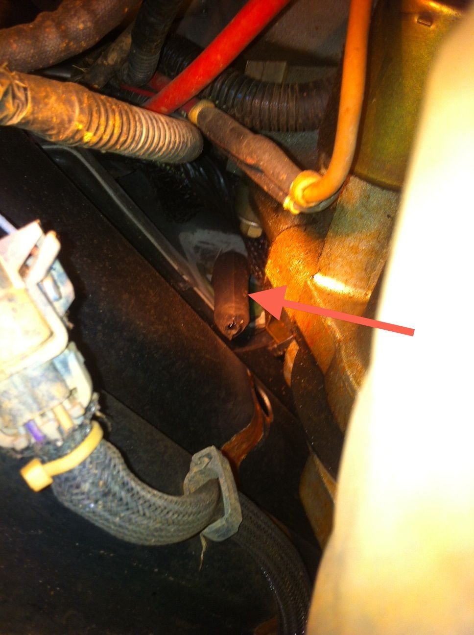

ok, so I may have jumped the gun. Looks like it's water, not coolant that was in a puddle dripping out from between the firewall and engine. I got underneath and can see where the water is coming from. I guess I should know what this is but don't. Fluid is coming straight out the hole in the bottom. Comes out of firewall just right of center on the passenger side. What the heck is this thing? I'm guessing an AC condensation drain?

They are called udders they are on both sides of the car

I haven't had it out in the rain for a long time. This one has to be draining AC condensation.

Th A/C drain is on the passenger side, I think.
Correct.
Like many cars/trucks, this drain is for the condensation that collects inside the HVAC housing inside the car caused by operating the AC, and has nothing to do with the "udders" being mentioned. BTW, be very glad is draining because if it doesn't, or can't (blockage), water will back up inside the HVAC housing and overflow inside the car. You do NOT want that.
"Udders" drain water from the plenum area at the base of the windshield, outside the car.
