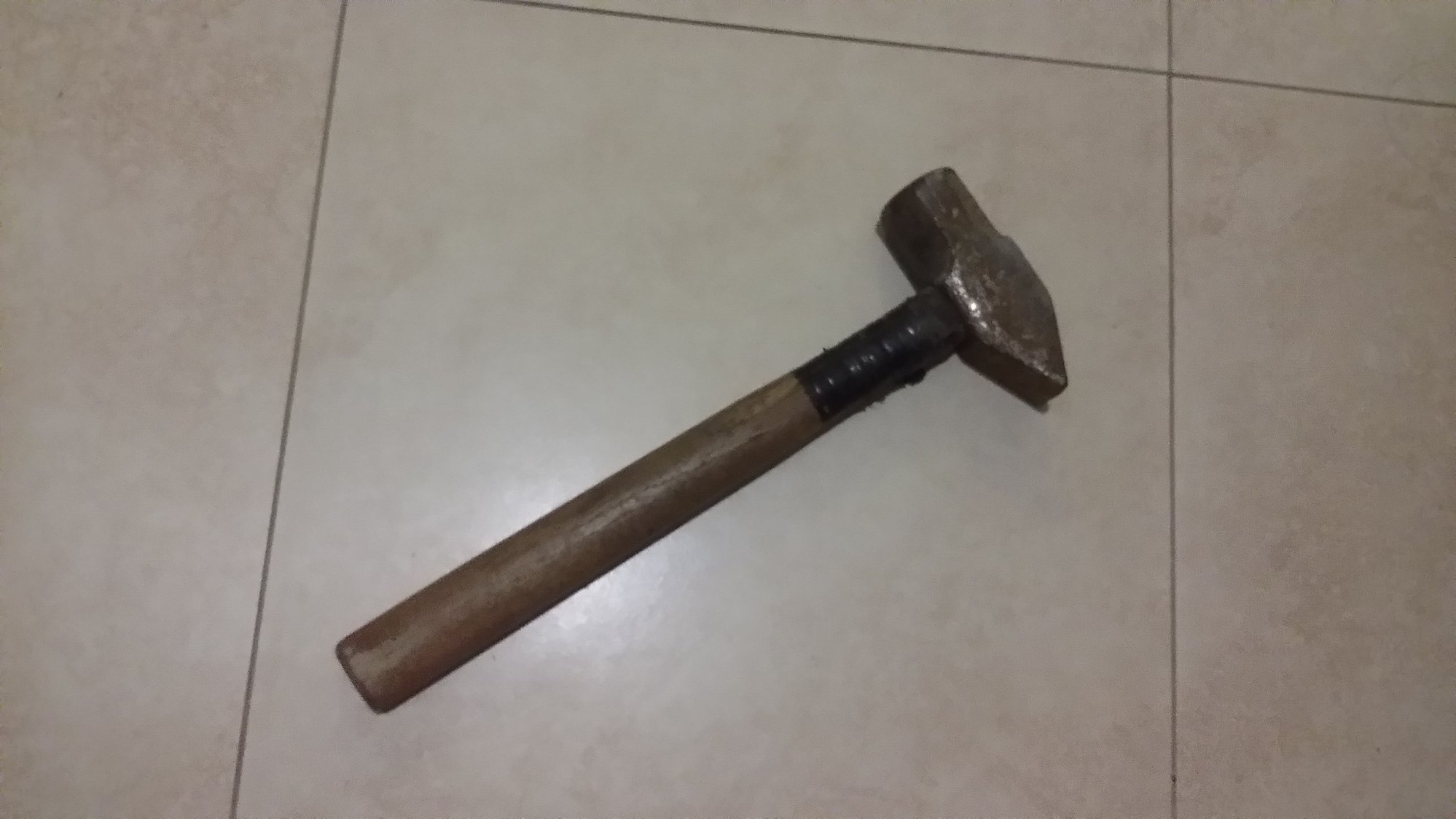

This can't be good. The header pipe is touching the steering linkage. Any ideas on a fix? I was just going to "tune" the pipe with a BFH to give some clearance. How much clearance is recommended?

I told them about this issue from DAY ONE when I muled the first set of test headers. Hard to believe that it was never resolved.
You can try to loosen the engine mount bolts and horse the engine towards the passengers side, There is a small bit of clearance that you can gain there.
Other wise, its a BFH cure.

Thanks guys, I just got it back out and did some measurements. It deflected the steering linkage 3 mm towards the wheel well. what should the CLEARANCE be when I am done? I think I will keep them since the goal here is not necessarily perfection for a show car I just want to drive it and have it sound good, extra HP is also a consideration. With the BFH method, combined with horsing the motor to the right I should be able to accomplish my goals. So any advice on clearance? 1/4 inch, 1/2 inch, or more?

When you think youve clearanced them enough, clearance them a lot more. Theyll expand with heat and start rubbing again. Ive got a set. Youre gonna need a big hammer bud.

1/4" will be good.

If your going to use the bfh, mark them with a sharpie first. If you can, heat the tube up, lay a piece of hd tubing against the tube the same angle as the steering shaft and hit that. It will look like it was made that way instead of having a bunch of hammer marks. Stainless steel doesn't bend as easy as mild steel.

You're right Bill, it would not be a huge ECO for the manufacturer. There is lots of room to move that pipe closer to the engine, just a bit of a twist before they weld it. I was not able to move the engine to the right at all, I am not sure if I was doing it correctly. And thanks, I went with 3/8"

I wish I read this before, you're right, it probably would have looked better, but a spin on the wire wheel and it was ok.
