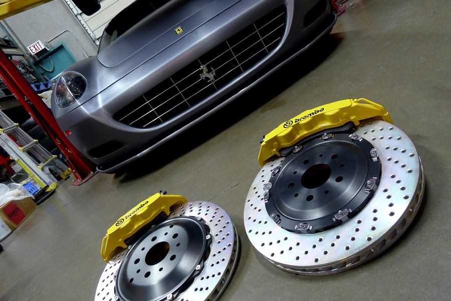

Damn! Even Ferrari got it wrong! My God, drilled discs on Ferraris! What is this world coming to?
