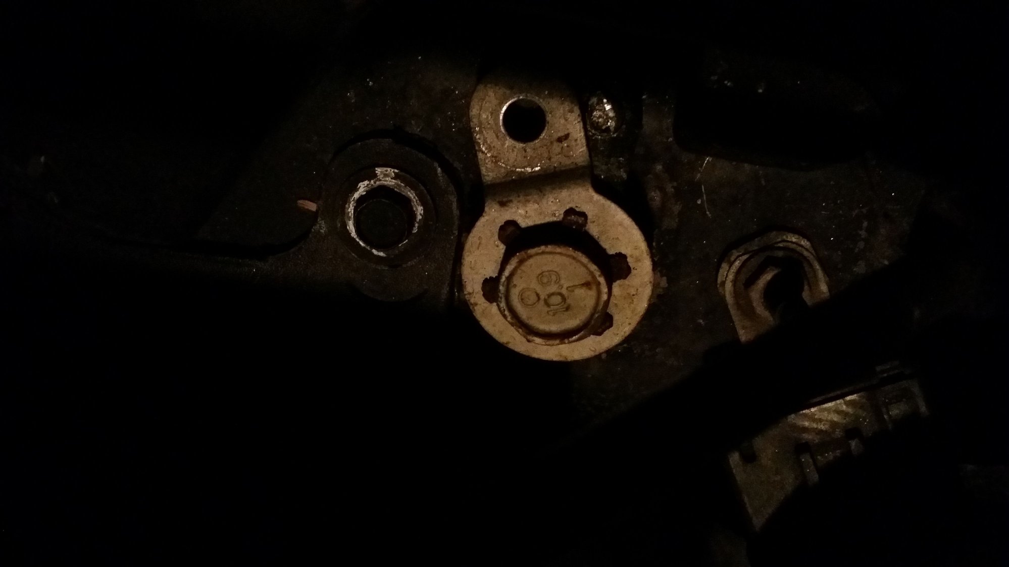

Hi, I found a bolt and rivet sharing a common washer/lock tab of sorts under the hood by the passenger's side ground behind the headlight bucket on the frame. The rivet is broken so the bolt and "washer" have turned a bit. The bolt head is stamped with 10.9. Can anyone tell me what that hardware is for? Thank you.

Picture, please...

Okay let me put it on my laptop and upload the picture. I can't figure out how to do it from my phone.

This is from the passenger's side but the pic loaded upside down.

Unsure how to load a picture from my phone, but I found it. Both sides. Mine looks a bit different, needs circlip pliers to remove. Same designation of 10.9, nothing attached to either.

That's 1 of the 4 bolts that go through your frame to hold your front cradle (same design for rear cradle)
Just loosen the cradle nut below, spin the tap back in position, add new rivet, re-tighten cradle nut
Someone probably used an impact gun to tighten that nut, which you're not supposed to do.

Okay, that's an odd think to randomly have broken. Thank you both very much.
