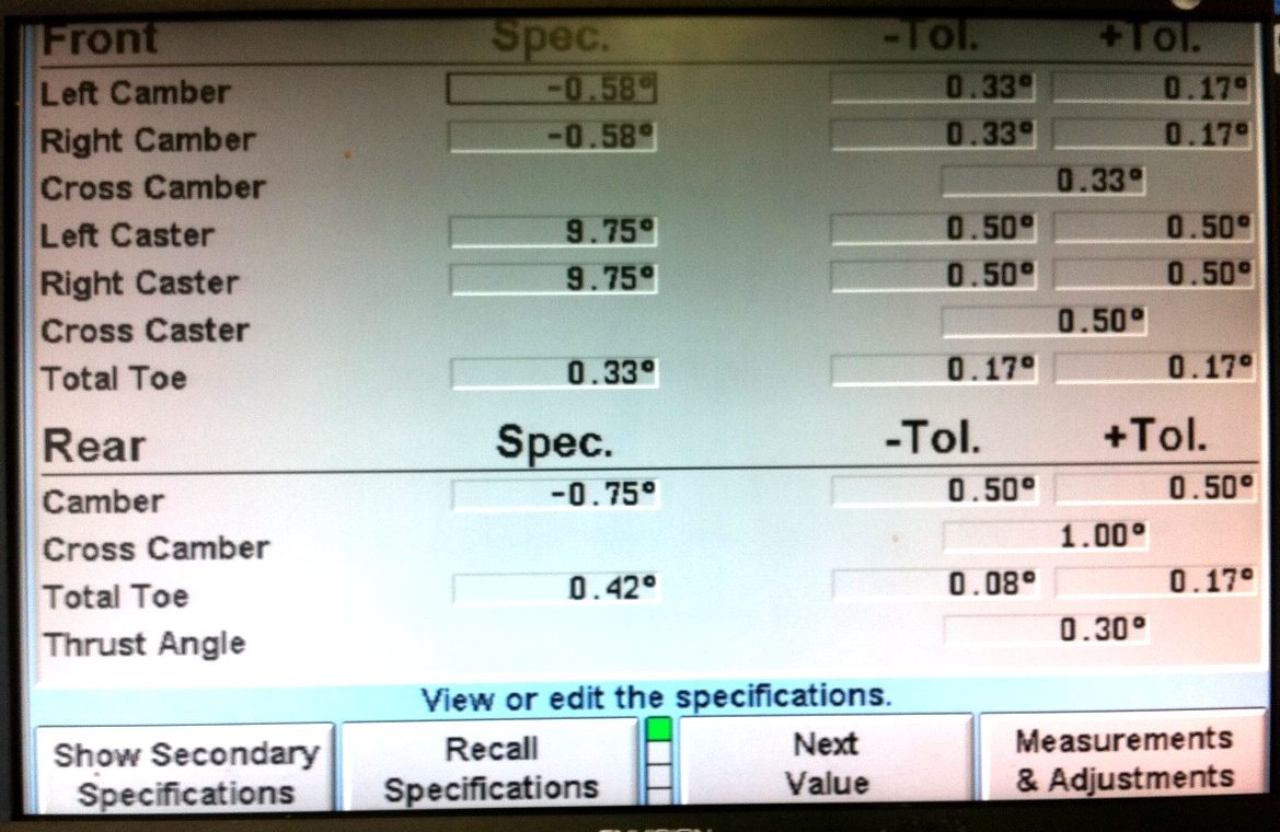

Am I going to have to post a picture of the alignment sheet I have in my hand with "specifications" over the column with the range allowed?
that explains some stuff right there. engineering degree. unfortunately the laymen world doesn't use engineering terminology. what i showed is a well accepted standard as every alignment machine hunter makes uses that exact spec screen. i went to hunter engineering for training. i use what they taught me.
sure show the sheet. seems you are in canada and that might be the difference in terminology.
are you referring to this sheet? which can be a cause of confusion for you here.

right off tire rack website . they used specification, not target.
http://www.tirerack.com/tires/tirete...e.jsp?techid=4
Alignment Ranges
The vehicle manufacturers' alignment specifications usually identify a "preferred" angle for camber, caster and toe (with preferred thrust angle always being zero). The manufacturers also provide the acceptable "minimum" and "maximum" angles for each specification.
another one in toronto
http://www.anewtoronto.com/wheel%20alignment.html
just to help clarify a misconception about what specs are, when people talk about car alignments, they don't say what are the specifications and tolerances.they just say what are the specs. never has ANYONE come to me and ask what are my car alignment targets?

you're right, i'm wrong. you win, i lose. i can't compete with your engineering degree, i don't know how i've been doing this wrong for the last 14 years of my life and getting away with people having great tire wear, increasing their fuel mileage slightly, and for a few winning their events. oh well, guess i'll just go kill myself over a word.
nice you can't even link to an acceptable definition for alignment terminology, yet i can. twice even.
in the real world, go and ask for a wood board 8 x 10. take it home and it doesn't fit because oh you gave them a tolerance of +/- 2".
The car was done yesterday, and drives much better. Your spec's were given to the mechanic and were spot on with what his were. Thx!
What ticks me off is the last one was done at GM and was triple the price.
glad to hear it worked out. just curious as to what the before numbers were.
He didn't say, but said the tow was off, and the driver rear was out.
i'll take it he didn't give you a printout. toe is the biggest killer of tires with camber being second in line.
