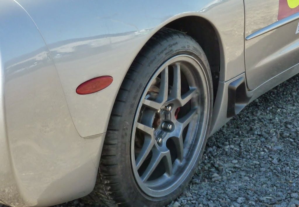

Don't have a 275 photo, but here's a 265/35/18 PSS on an OEM 18x10.5 Z06 wheel:
It's a bit of a stretch but not too terrible.

Thanks for the pic Troy. Do you find the rim protector to remain effective?

I can't say that I ever actually tested it to be honest, but I doubt it would be very effective. I just try to stay far away from curbs and tilt the right side mirror down when parking to be sure I'm nowhere near it (I've only actually had occasion to do this maybe twice since I've owned the car - it's extremely rare that I ever have to parallel park any vehicle).
