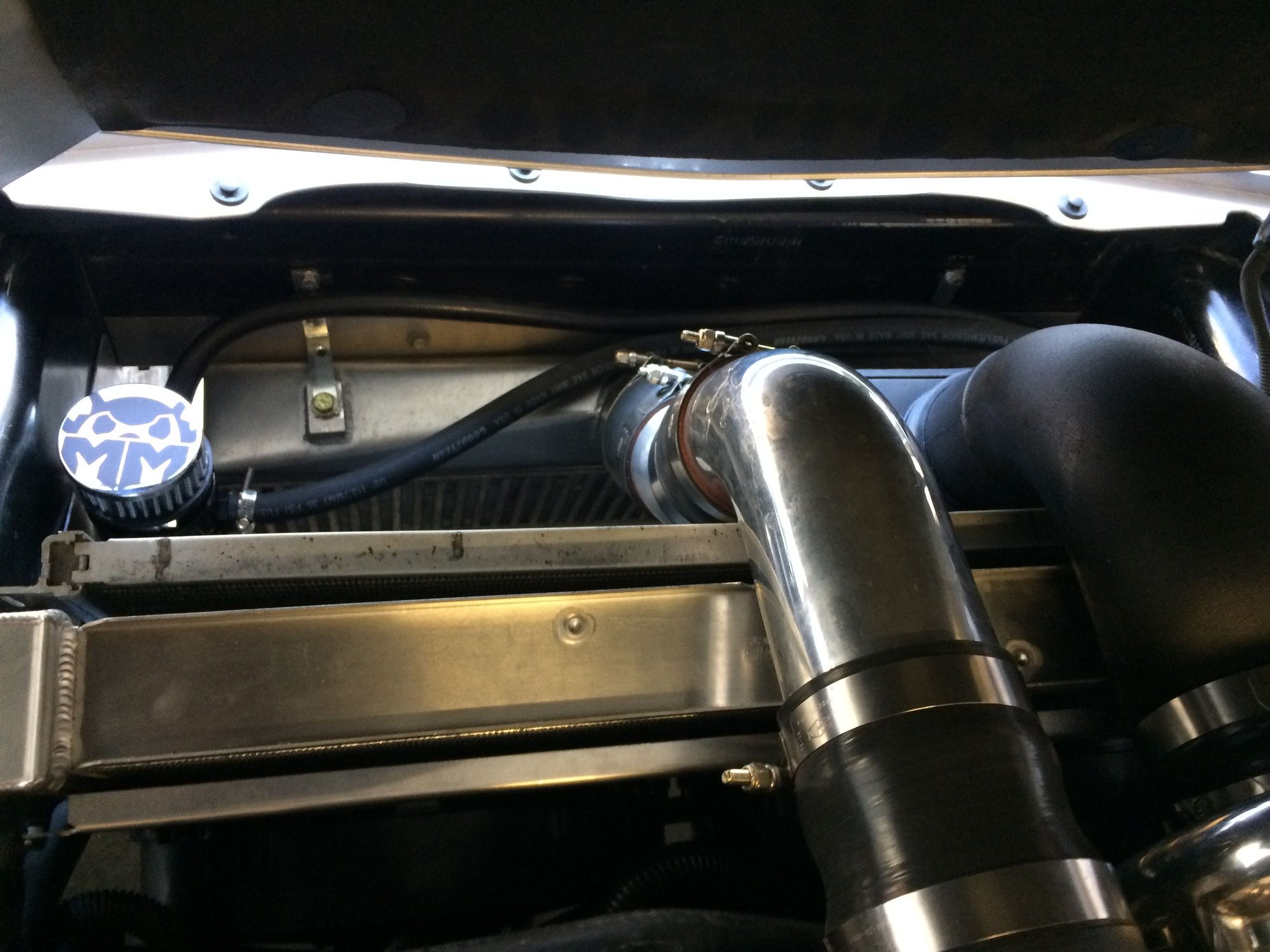

Most here seem to have their own setup based on their configuration needs and constraints. Here's what I'm doing on my new setup - DeWitts cut-down radiator (model 1139197E with built-in oil cooler) since I'm running a 4" intake, C6 oil line adapter block/lines with built-in high-pressure bypass feeding the DeWitts rad, 180 deg. t-stat, brushless Spal fan setup with dedicated temp sensor (built-in dedicated controller and 30% higher capacity than previous Spal dual fan setup). I'm also doing my best to provide the maximum air flow possible to my IC and rad by directing air as best I can and sealing the intake area of leaks. I also have an original MCM heat extractor hood that will be replacing my stocker.
Dewitts cut-down rad and Spal brushless setup. The fans are NOT wired to, or controlled by, the PCM but are wired directly to the battery. The temp sensor and dedicated controls keep the fans at the optimal speed. There is also the option to wire in an inline switch for continuous operation.
Mocked up without rad/IC cover in place. There appears sufficient space to move enough air in.
Needs TR paint
Fingers crossed that this setup performs as needed for the SoCal environment. Gets pretty hot here in Elsinore.
