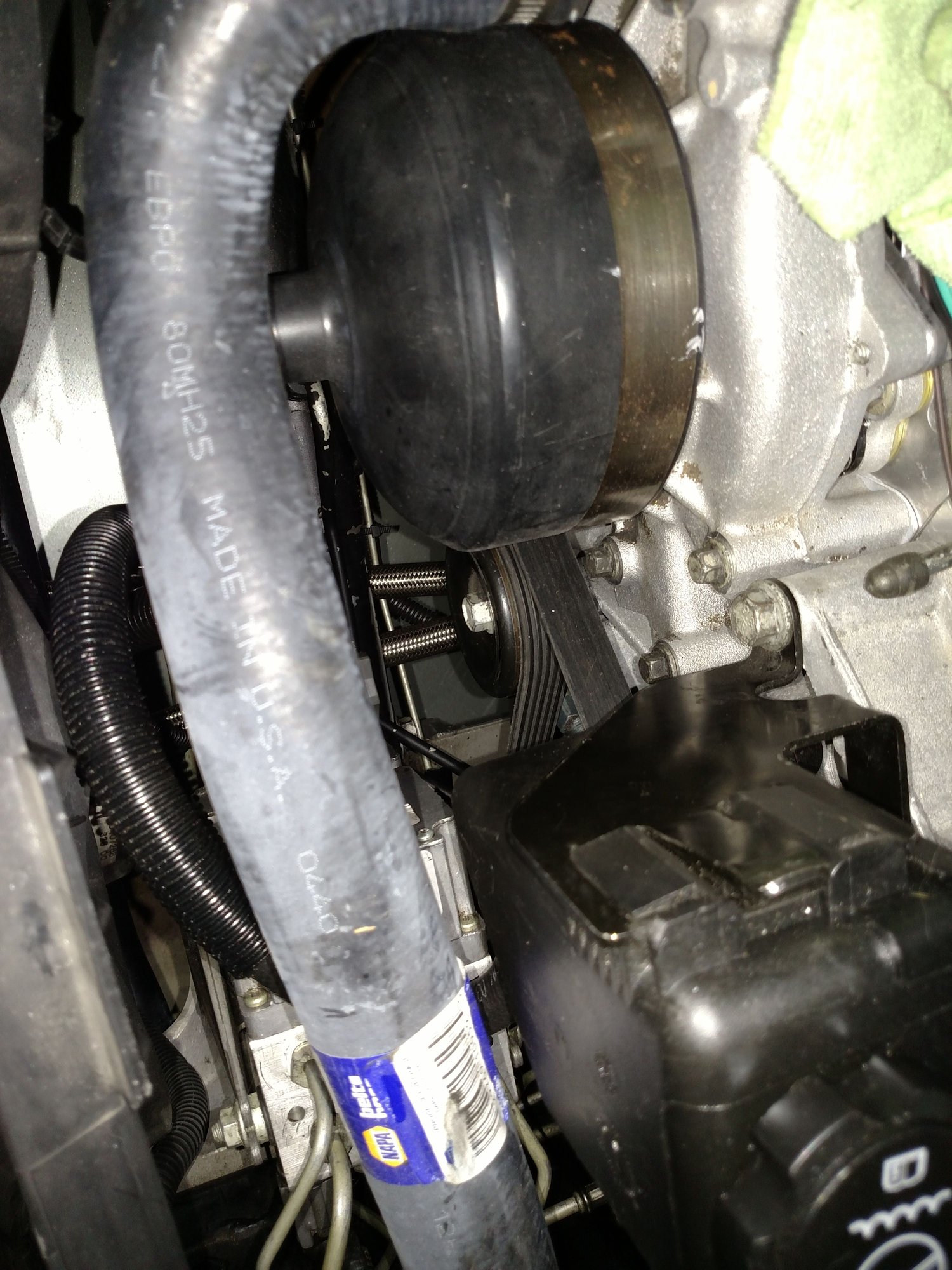

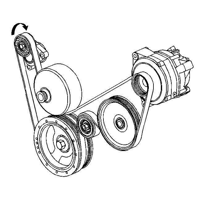

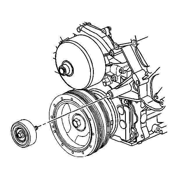

Ok, tracking now. here's pics first:
This is the main belt/accessory belt
This pulley comes off using a 15mm wrench/socket.
From the top, you'll have to squeeze past the radiator hose or go under the water pump bell. See pics from my engine bay below:
shiny bolt in the center of pic? that's the idler pulley bolt.
see where my hand is coming under from? that's how I get to the idler pulley bolt.
If you need help PM me, I'm in New Haven, up the highway.
Jamie
