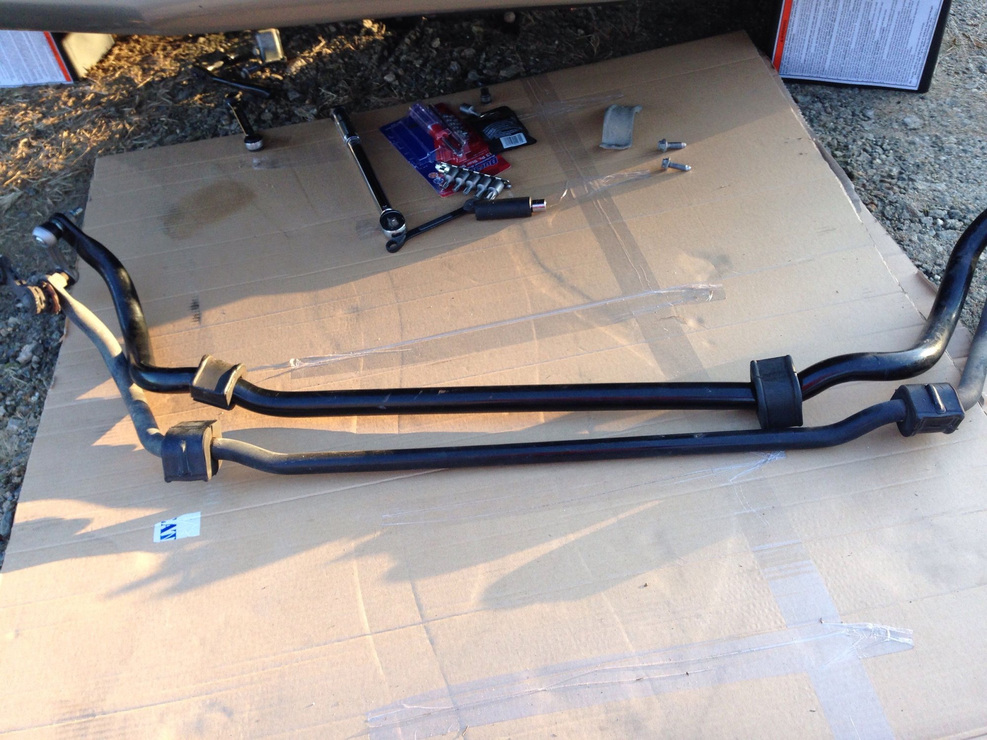

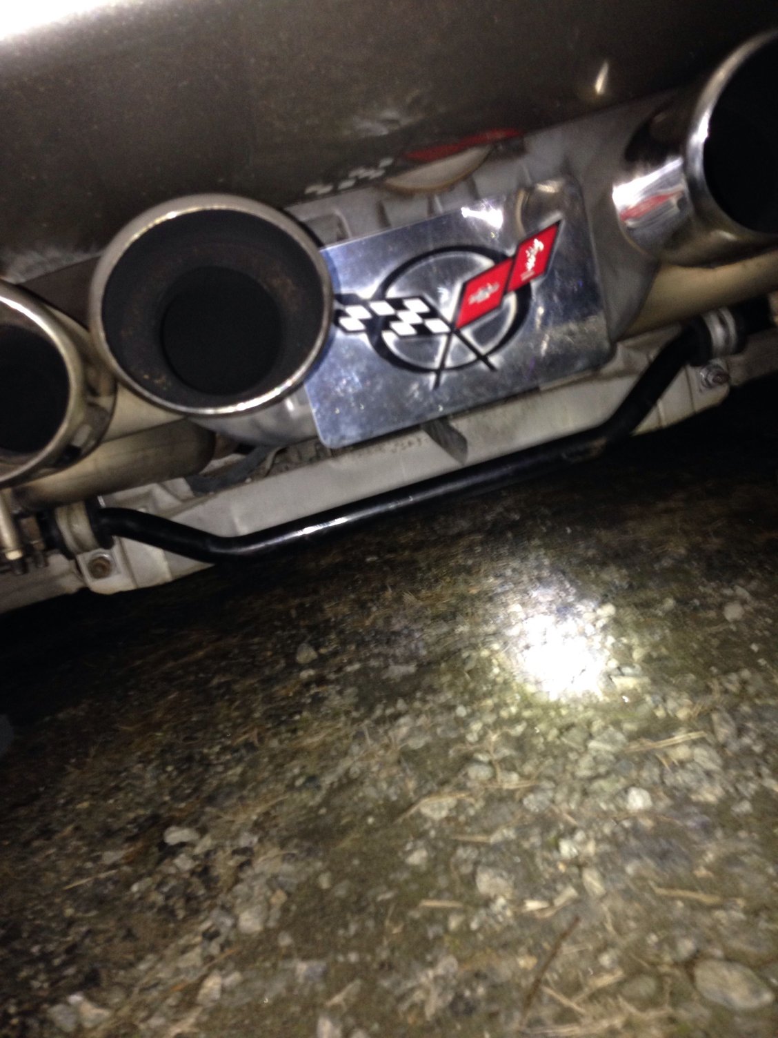

finished up the install today, front is on! The front was a 20 minute job. Road feel is amazing and the car is super flat now! Needs new tires before I really test them but so far so good! Coilovers will be the next step and I believe will set the car off completely!
Rear sway bar
Rhino ramps help so much these are so useful
Stock front and c6 z06 front comparison
17 year old plastic end links
