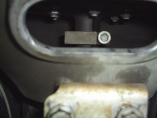

IMPORTANT: the following step MUST be performed in order to provide proper alignment of the propeller shaft hub, the propeller input shaft and the propeller input shaft front bearing
This is to torque the bolt in the following picture. You reinstall everything, start the car wait for operating temperature and torque at the bolt to 96 lb ft.
