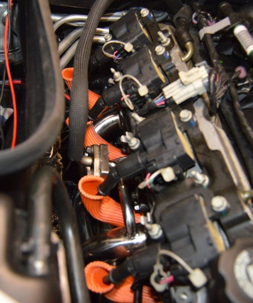

Wondering how to fix this? It's only on one plug. I'm running LG long tubes and bought plug wires also from LG.. Can the boot be trimmed and moved in tighter so no contact is made?

Different wire, with a flexible plug end?

, msd is the only one I know of with a bendable end... I run lg superpros myself and the plug wire routing is less that desirable

I picked these heat resistant sleeves on amazon for my msd wires. Work amazing

As I recall the GM LS7 wires have a 90 degree boot.

I had the same problem.
Solution - CoolSox

The MSD wires with the flexible boots are working great for me.

I had the same problem with my xs power headers, one wire was rubbing the headers, i tried the coolsox, worked great for a few weeks but eventually it burnt a hole in it and cooked my wire. Went with msd wires with the bendable boots and problem solved.

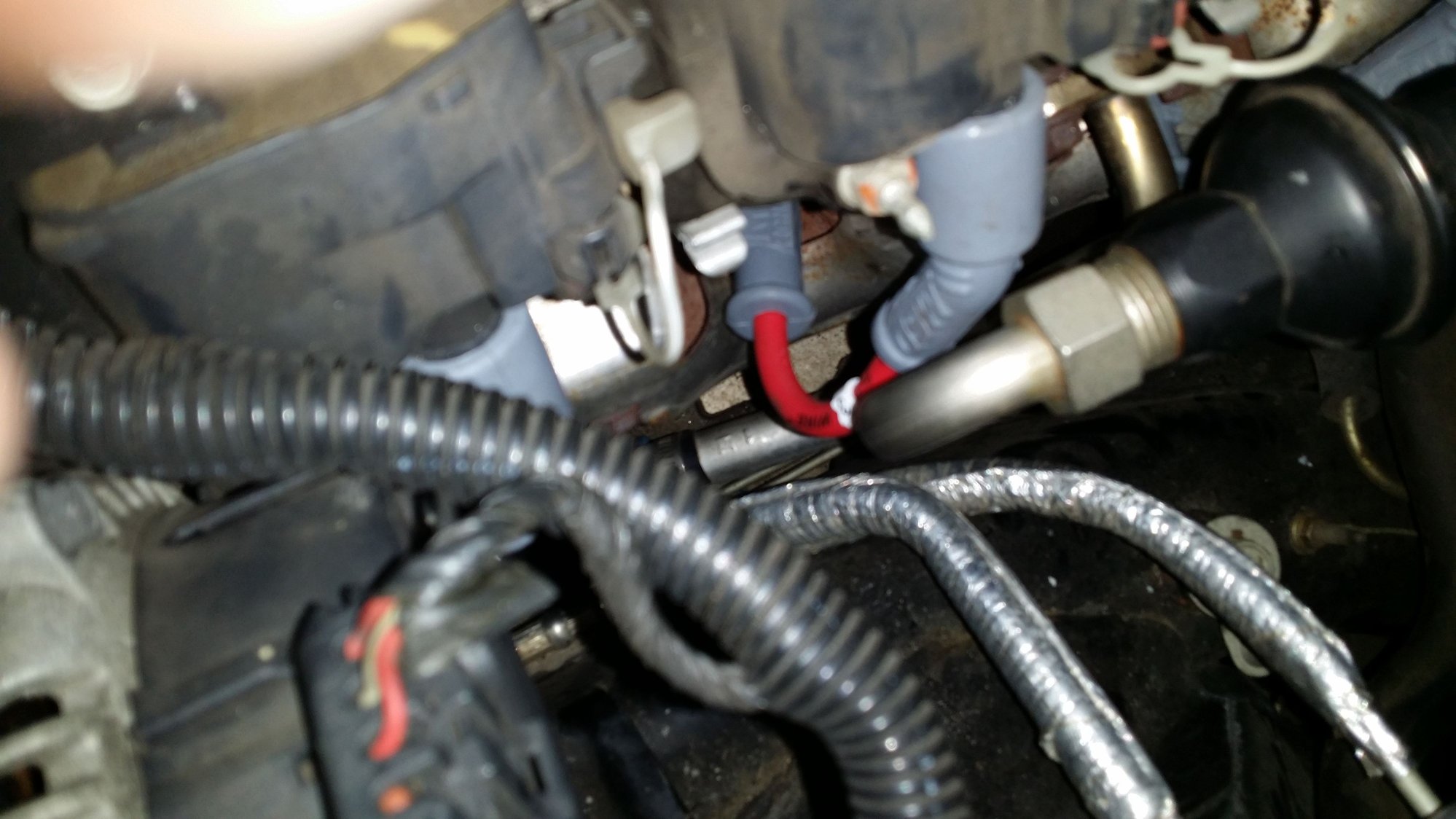

I tried bending the boots and twisting the coil end to different angles but it still touches. See pic, what do I do?
No matter how I adjust it, the wire always touches that silver pipe

I don't have LG but I used header wrap on my #4 pipe also have socks !!!

I used the foil tape you get at Home Depot for heating ducts. Wrapped a couple layers around the silicon boot and no more melting. Make sure to keep the tape away from the wire as it is conductive.

I did the same thing as pounder. Even with the heat sock the plug wire/boot would smoke after driving... added a few layers of wrap around the header and AIR fitting and all is good now.
