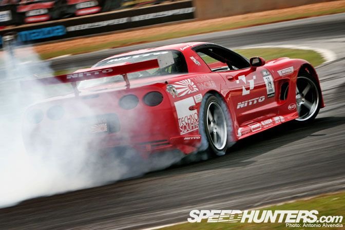

This is the C5 drift car:
As you can see, it has wider front fenders, which allowed them to push the wheels further out and avoid hitting the inner fenders. (If the inner fenders are even there.)
