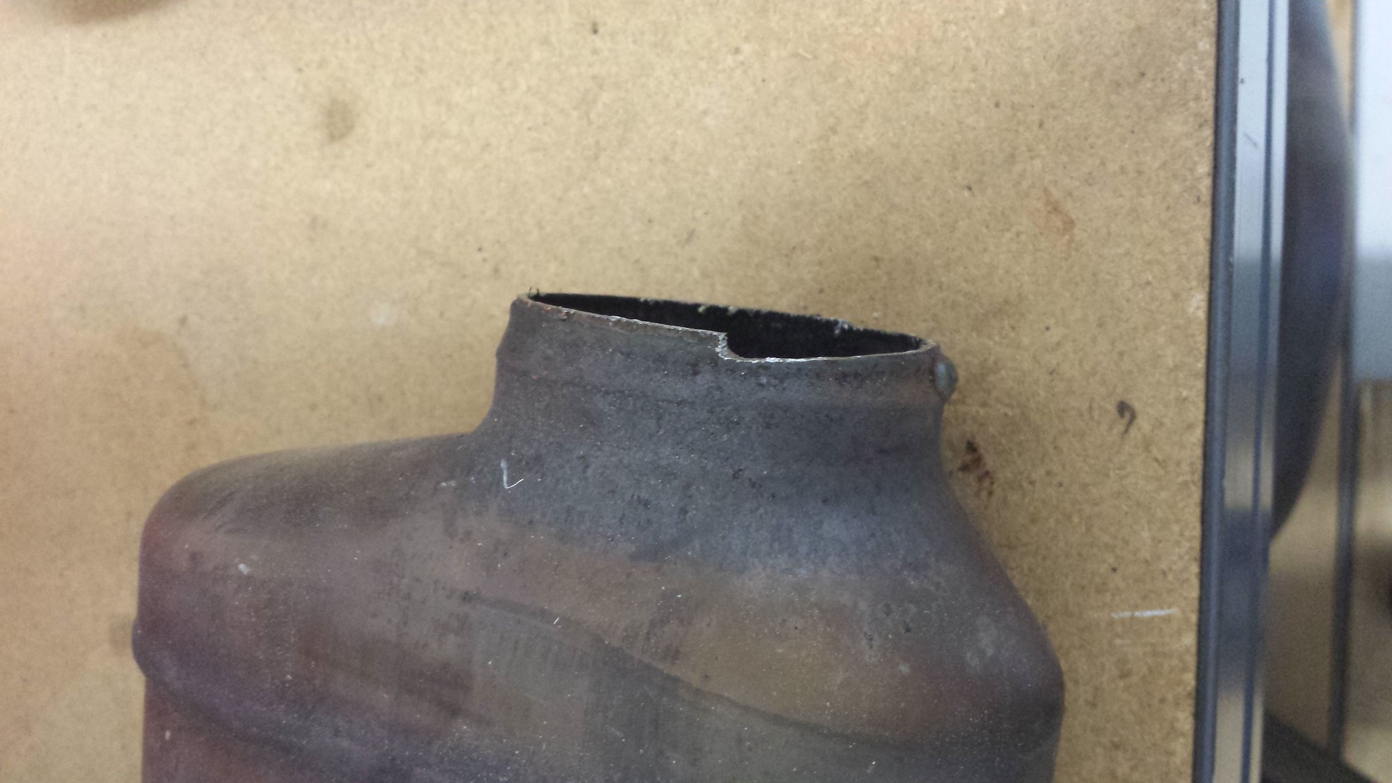

Ok sounds good. The stock cats look good no clogging or anything loose. The only part with them I was worried about is the cuts arent exactly straight down from when they were cut off. Im sure they can be welded back on fine but I was concerned with having a leak. They arent botched but they arent completely even cuts.
Old Apr 7, 2015 | 09:08 PM
bwill03z's Avatar
bwill03z
Joined: Nov 2011
Posts: 3,187
Likes: 265
Heres a pic
