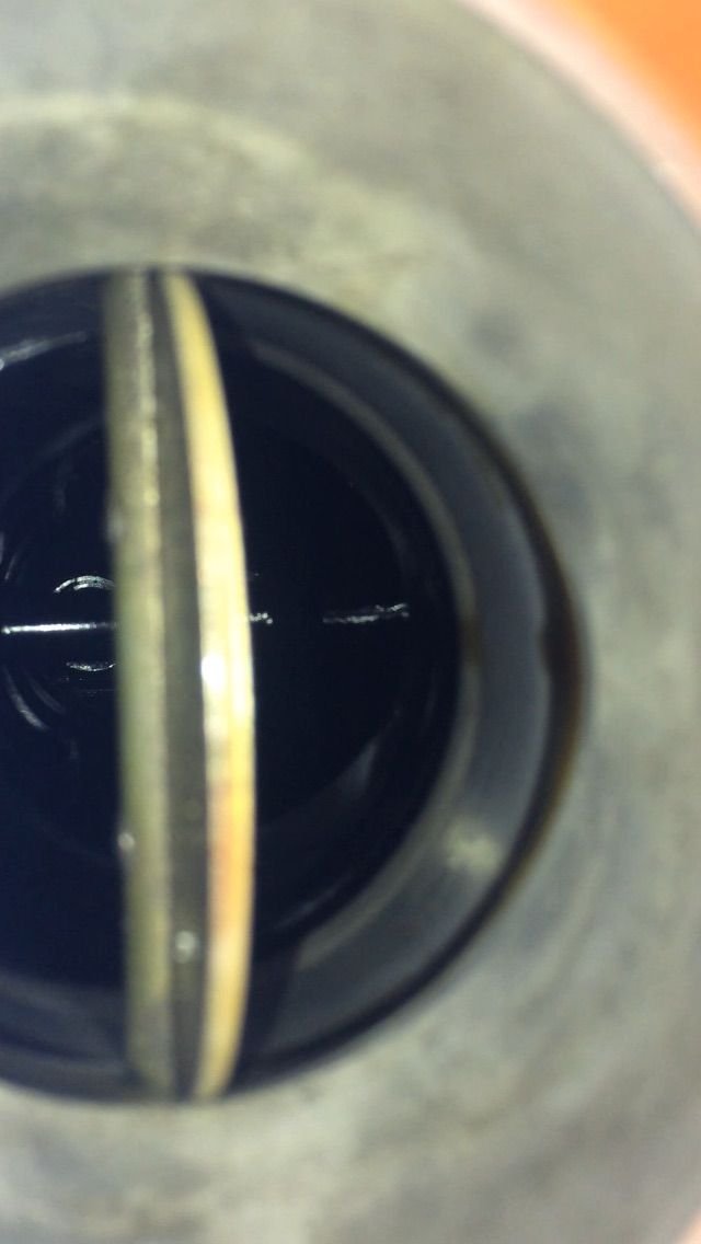

From: Greensboro Nc
No Catch can right now, I pulled my vararam off to clean the TB and it was honestly almost completely dry. there was a bit of buildup, but no oil actually pooling. TB hasn't been cleaned or touched in well over a year when I last had it ported/polished. will post a pic of it when I get the chance.

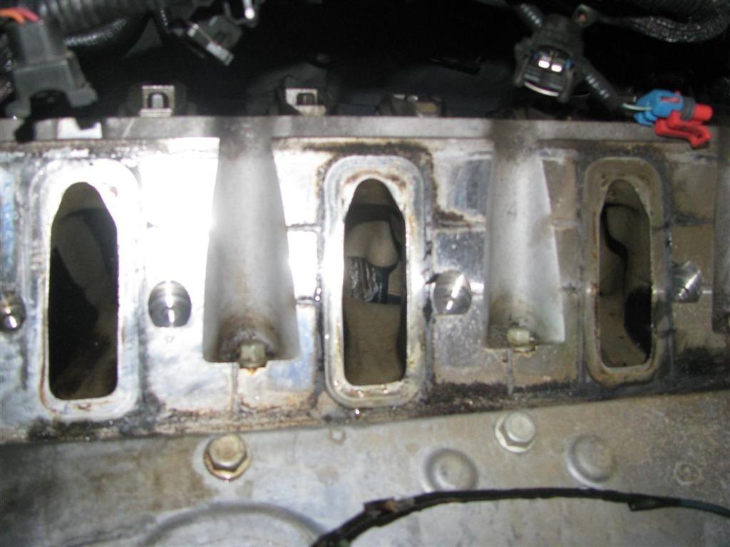

Old Apr 8, 2015 | 03:28 PM
eevette2001's Avatar
eevette2001
Joined: Mar 2015
Posts: 81
Do a leakdown test, if it's good then it's the valve seals.

Posts: 81
So even if a compression test shows good on all cylinders I need to do a leak down test?
You need to determine where the leak is (top or bottom of the cylinder-i.e. rings or valves). I you hear air leaking out of the crankcase it's most likely your rings causing the oil consumption. If you can get a look at the top of the valves, you'll be able to tell if the oil is leaking down the valves.

Pulling the intake on theses cars is simple, you could do that and look at the top of the intake valves, if they are covered in coked up oil deposits you found the issue.
The leakdown test would tell you the issue is not rings but I'm betting with the way you describe it, it's valve seals.
