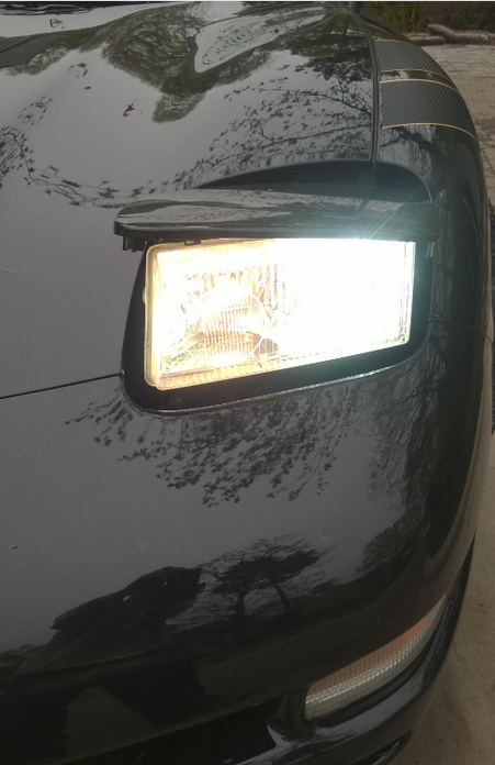

Try a HID bulb conversion and 4-hi harness like I did. Huge difference at night. Just adjust your beams down a little to insure you don't blind anyone with scatter.
No ones complained about mine and I've driven behind friends and asked...
If you drive a lot at night and want the best, get the full projector conversion! I'm sure it would make HID even better! I'm very happy so far with the improvements I've made at minimal cost. HID of some sort is the "only" way to go!
edited to add HID+4HiLo pic:
