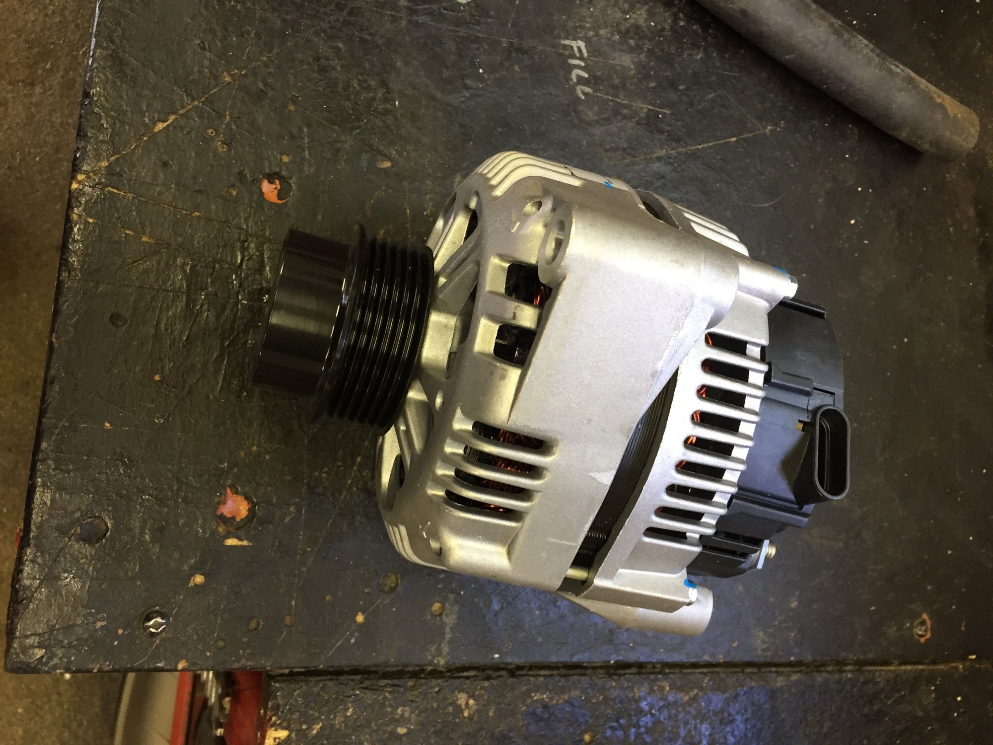

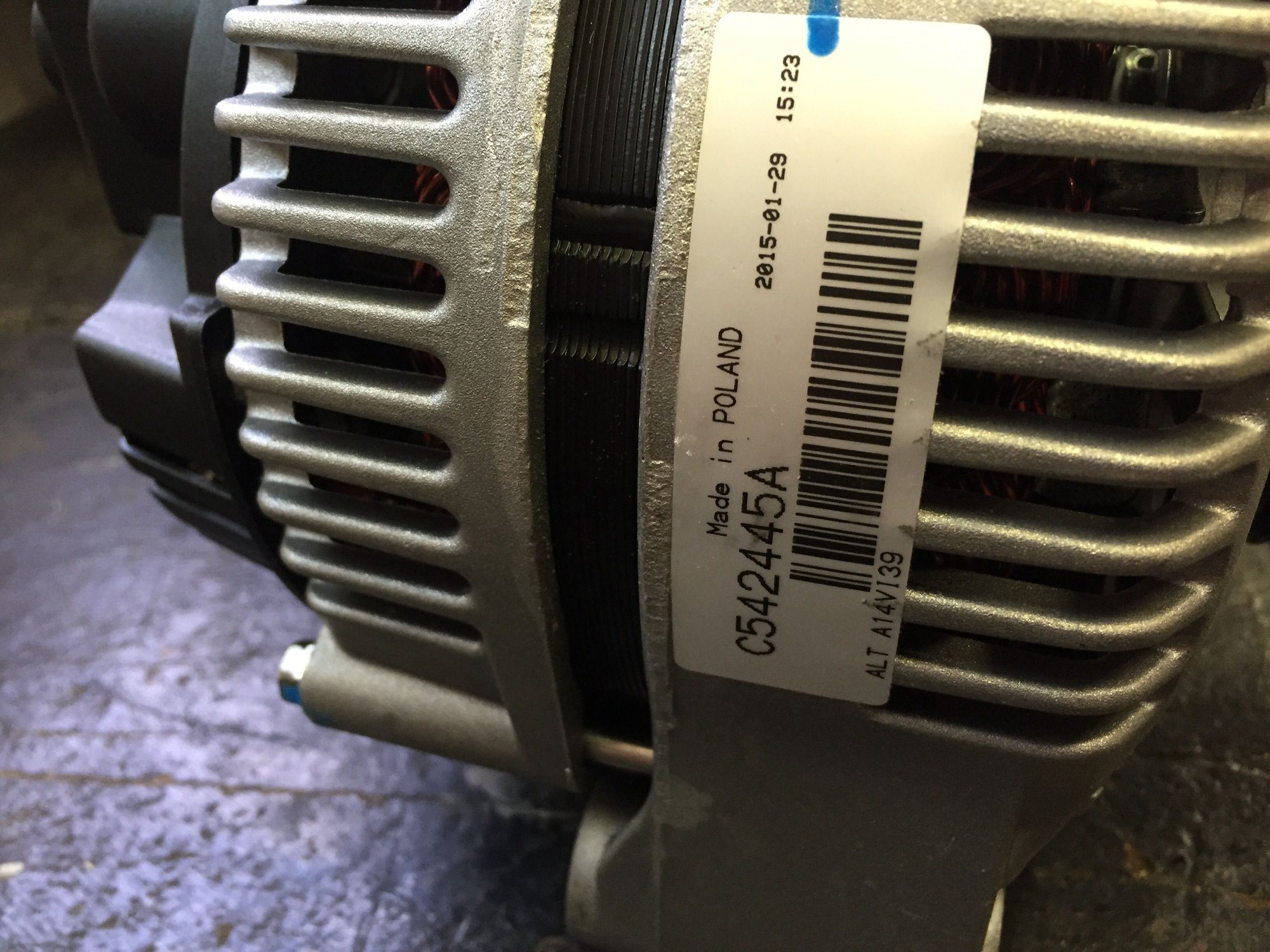

I got the new unit from jobber but does not look oem sticker says 14v 139 which seams to be 140amp? Any thoughts ?

that's not oem, i'm not even sure if you can get oem anymore
ac delco are all either new or reman, reman being the only way to get oem
you should have just rebuilt your OE like we all were suggesting

It looks like a Valeo case but it's hard if it's correct from a few pictures. Are there any significant differences between that one and your original? It's the right number so you might as well try it.
110A vs 140A doesn't make any difference despite claims on this forum. The PWM signal that tells the PCM the field winding duty cycle still goes from 0% to 100% no matter how many amps the alternator can produce. There is no output current sensing or electrical load sensing in a C5 so the PCM can't know the alternator is producing more than it's rated 110A. All the PCM knows is that the alternator is working at 30% of maximum output or 85% of maximum output as examples.

Yes I know I can have rebuilt right now I am trying to understand what's what this new unit is correct part number and listed as oem with notes on computer as valeo but not sticker up like my original . Pulley is different being so it has clutch style but maybe this is what the replacements are nowadays
Maybe if I got from dealer this is what they would ship me too who knows
I think since they don't make anymore Valeo units this is the new part and its used on auto or m6 cars to make things more simple

Well I can tell you it is NOT OEM for your car since it has a decoupler as I have discussed before. That will have no effect on electrical performance.
Whether or not it will work and not throw messages I have no clue. Made in Poland is not a good sign.

I think this is now the replacement to oem new if anyone wants to order one. I was researching and there are no valeo units made anymore like when the part number was 10246634. as we know that number was replaced with 10316182.
I also found out that 10316182 part number came out back in 2004.
also if you look up 10316182 they are all sold with that style pulley now. so forsure looks like they did this to simplify things.
ps installed last night and working fine.

Yes, they probably combined all the different combinations into a single 140A clutched alternator since that will work on every C5.
