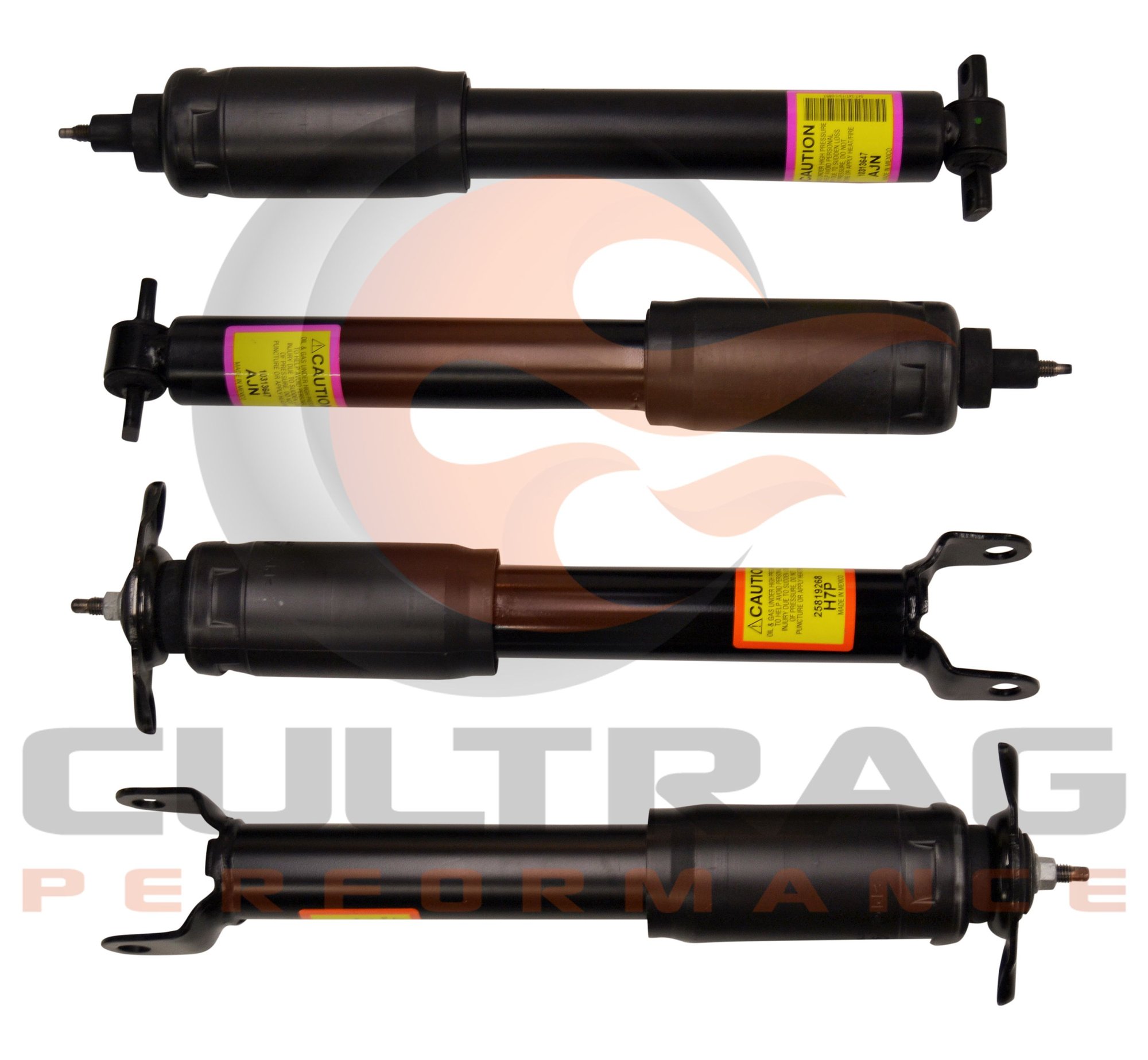

Any year will work but you'll want to use the C6 Z06 shocks from the 2013 since they are the best bang for the buck. You can order them on our website at the link below.
http://www.cultragfactoryparts.com/c...t/c6z06shocks/
