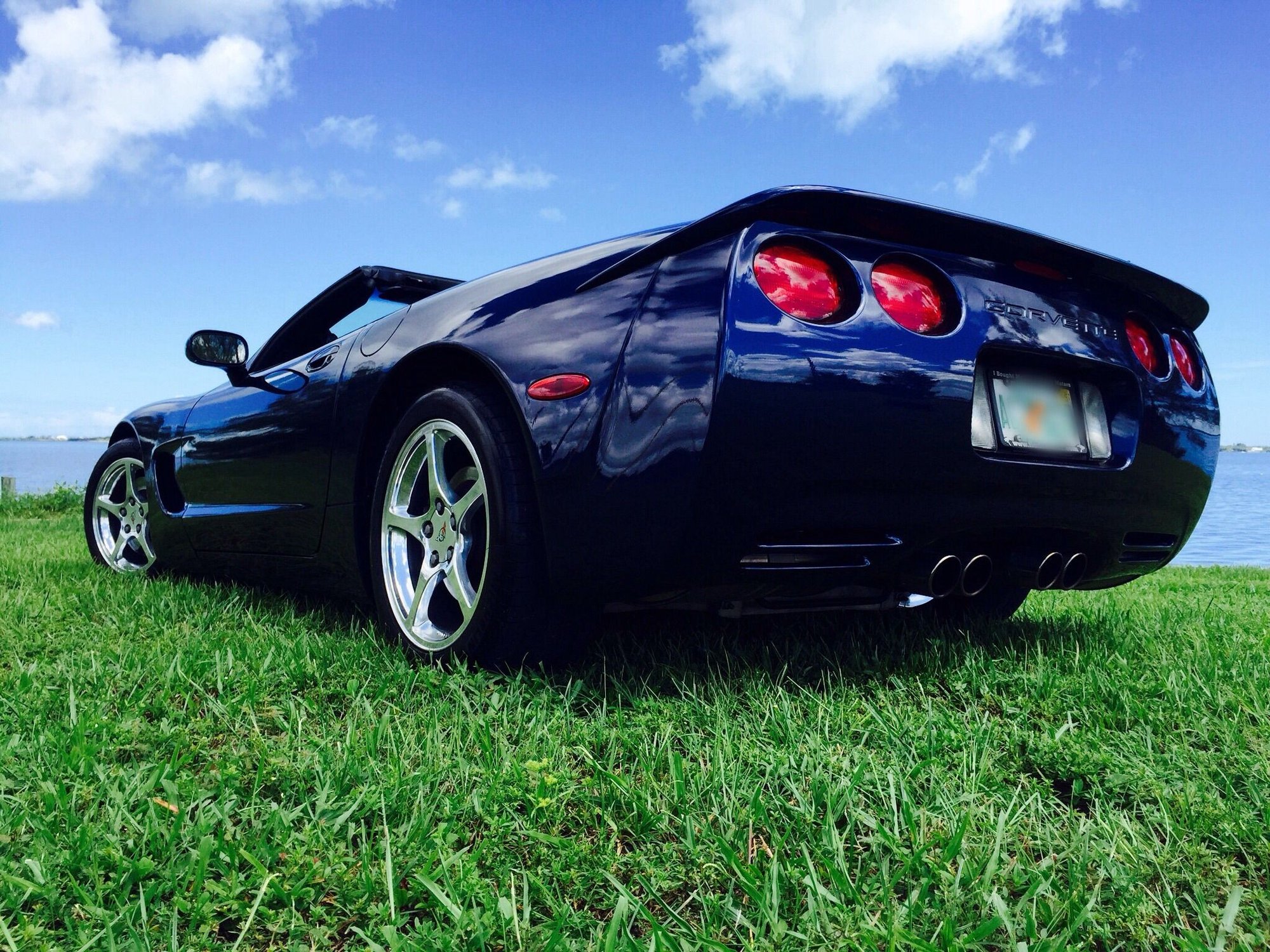

I bought a used Caravaggio spoiler and didn't look at it real close but I noticed the paint was not real flat like it had runs in clear coat from bad paint job,I also noticed some fiber glass cloth print showing through. This did not bother me as it needed to be painted the color of my car so I was more concerned with the fit which was perfect. I took it to body shop to have them prep and paint figuring they could get spoiler looking nice and smooth before painting, they noticed the surface was actually starting to bubble up some,, they cut into it and found fiber glass separating from foam underneath,,, seems it is foam sandwiched between fiberglass. So is this a common problem or did I get a bad spoiler? They are going to fix it since I own it now it will just take longer and cost more
Any thoughts, I have seen very few in person and did not study finish just fit.

Default Update after paint job
Thought I would update this old thread. Body shop did an amazing job fixing this spoiler, it is perfect , no signs of fiber glass in paint at all, it is smoother than the body of car!

Looking at the pics, your body shop did a very good job on the spoiler.
Thanks, I've seen a few on cars at shows, not many as smooth as this!
I know this shop and the guys and knew they would get it right. I would not put it on the car if it was not at least as good as the rest of the paint!
I've seen too many bad paint jobs on aftermarket hoods to do that to my car people may not like it but they can't say it does not fit or match
