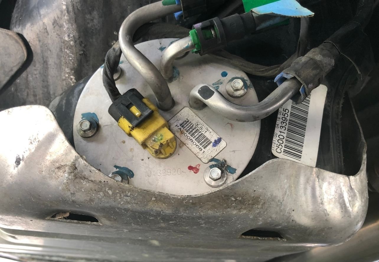

Does anyone have a brand name for the original fuel pump on a 2001? Is it delphi or acdelco?
Old Mar 14, 2025 | 02:16 PM
lucky131969's Avatar
lucky131969
Posts: 19,401
Likes: 1,141
From: Dyer, IN
Neither. Should have the GM number engraved on the pump flange.
Part number for the 2001 OEM fuel pump is 10432920.

Is there any way this fuel pump is less than 2 months old? I was told it was replaced Feb 5th. I dont believe it but I want to be sure before I make accusations.
nothing looks right there. Replaced with a used pump is more like it.
