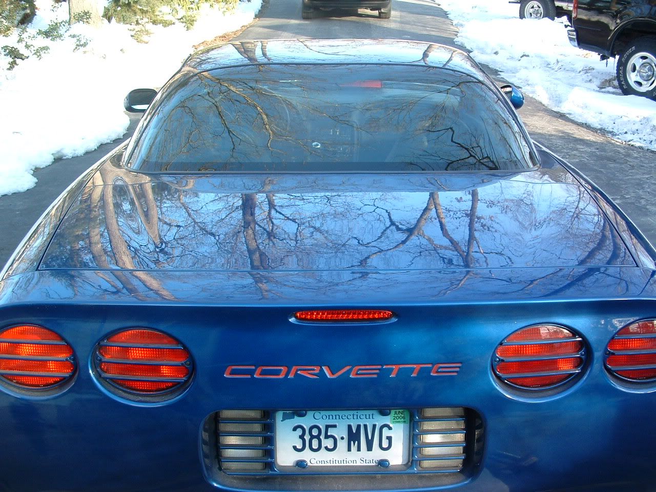

You have a FRC. If you look carefully,, you will see that I did the Read Deck Emblem REMOVAL MOD!!!!
I also added the front hood to fender seals to the rear deck lid!
Helps keep the dirt out of the hinge/ drain area.
