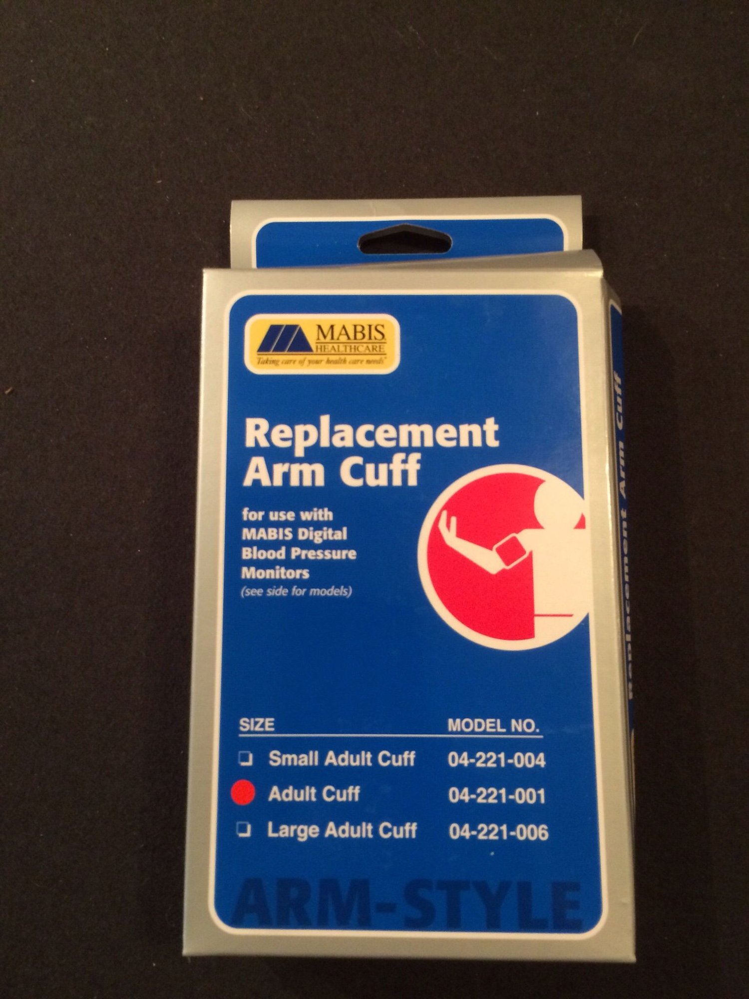

Default Lumbar
This is what we used, bought the on line, Google search the bladders<br/>http://www.schoolkidshealthcare.com/category/blood-pressure-cuff-replacement-parts<br/><br/>
I used contact cement on the bladder and seat frame, then attached them. You can use child size for the lumbar if you like, we used adult on everything. The hoses are the same size as GM so they plug right up.
Sounds confusing but once you get the seat apart it's really simple. I wish I had taken photos but I didn't.<br/>Hope this helps

Thanks for the info. I will share it with others in the future.
