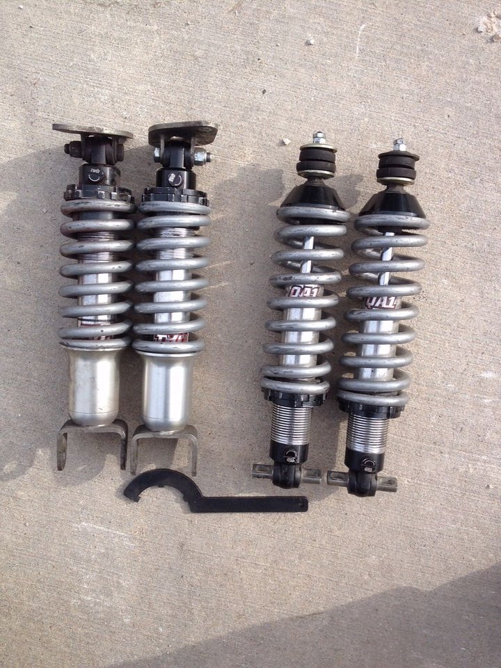

I have a set of QA1 for sale that I had on mine for HPDE.
They are single adjustable & work great on the street on the softer
Setting. $800.00 shipped
Pm if interested.

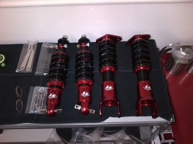

I went with LG GT2's, std setup from Lou. Extremely happy with the drop in height and ride quality/performance on the street. I don't track or autocross. Set up was easy and dialed in the settings quickly to my preference. Great products!!
