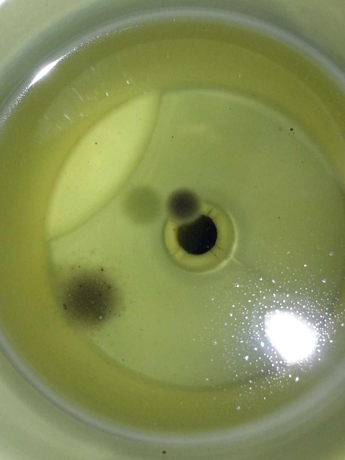

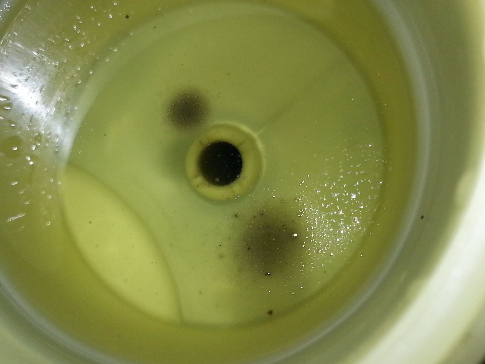

I've done the Ranger method on 3 occasions, most recently on Monday. 7 clean-out sessions and about 250 pumps total. At the end of Monday's Ranger regiment, these tiny black blobs were still floating up in the resivior.
The little blobs slowly dissolved into the fresh fluid. Could I have a severely sludged up Slave that is sticking? I can't think of what else could be wrong besides a sticking master or slave, but the pedals feels good, never sticks down. Engagement is close to the top. Disengagement is clean and full. Thanks for listening, all tips greatly appreciated!!
