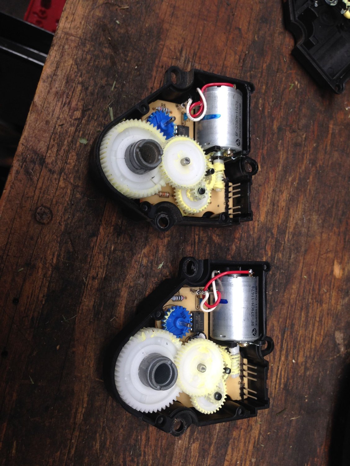

Well update I reset the actuators and it was all working perfectly for a few days and then today the passenger side started blowing warm.
Reset actuators and no change. Then turned pass side temp dial to the middle and reset. Now it's blowing cold in all vents. The actuator by the stereo is constantly buzz buzz buzzing even while the system is on and blowing cold air. Is this acutator that controls the drivers side temp? And there's another actuator that controls the passenger side? Where is it? I want to start swapping in new actuators to see if that's the problem. My access to a backup HVAC unit is more limited.

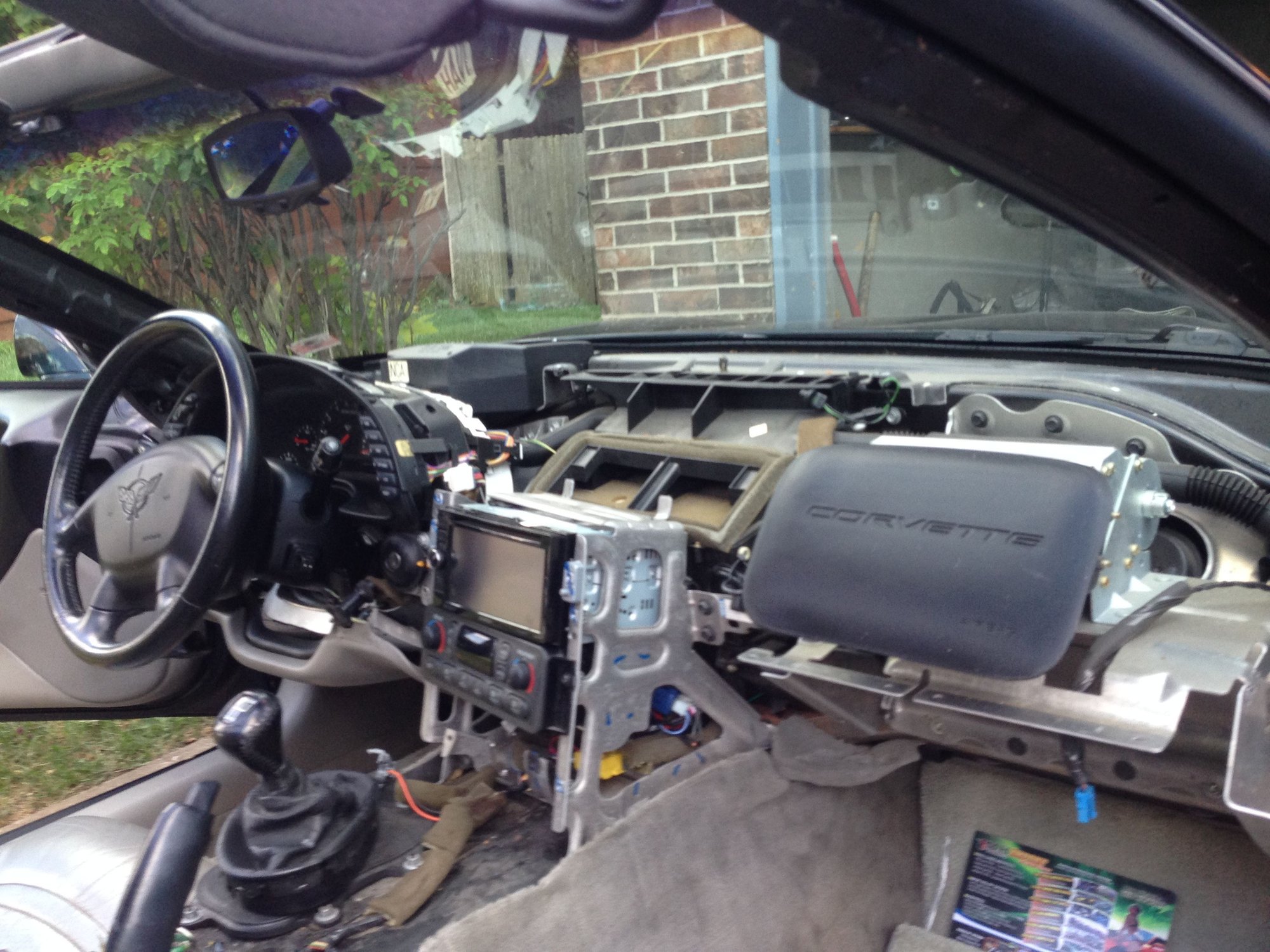

took 30 mins to pull the dash, another 30 to get motors off, both have cracked gears.
Old Aug 1, 2015 | 05:02 PM
73Corvette's Avatar
73Corvette
Joined: Feb 2012
Posts: 6,644
Likes: 479
From: OK
Nice work...keep us updated!.
Old Aug 1, 2015 | 06:40 PM
mrlmd's Avatar
mrlmd
Joined: Jun 2013
Posts: 1,965
Likes: 343
From: Shell Point (Crawfordville) Florida
Wow, kudos to you for your perseverance, research, mechanical skills, in finding the problem. Hopefully when you repair/replace those and get it all back together, it will all work well. Then you'll be complaining about freezing your *** off.
