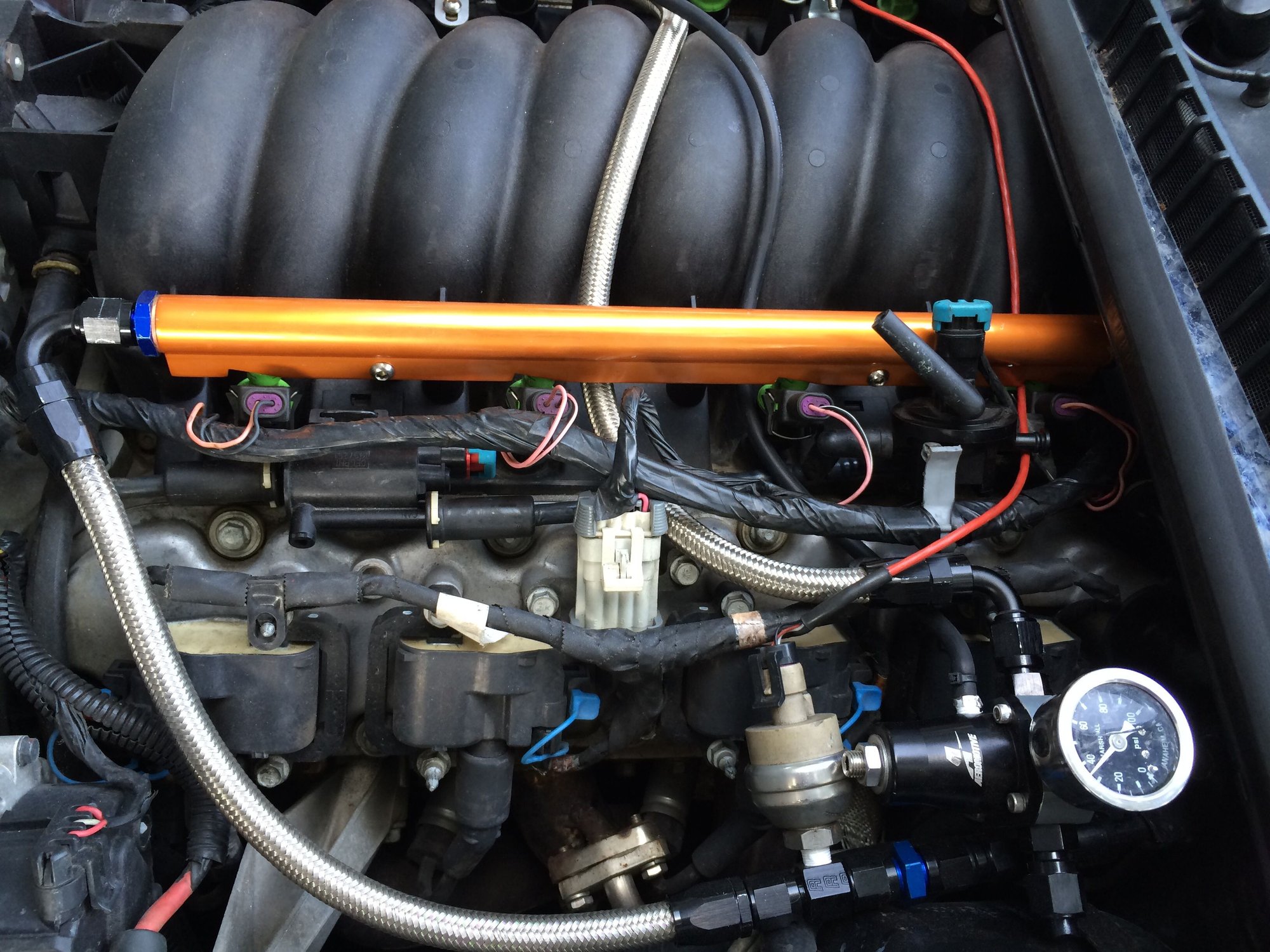

Any idea what the valve is on right side of photo. It's Tee off the vacuum line running along fuel rail. There a broke line on it. I have flipped up. But see no where it goes

Well,,, theres a Fuel pressure regulator and gage and attached to that is a fuel pressure sensor OR a low fuel pressure cut out switch.. Cant tell by looking at it.
What fuel pressure are you running as indicated by that gage????
BC

It's 55psi at idle. And raises 1:1 with boost
This part I circled. Line broke I turned up. Can't find where it went. I put a cap on it. And put 10 miles on it. No light.
