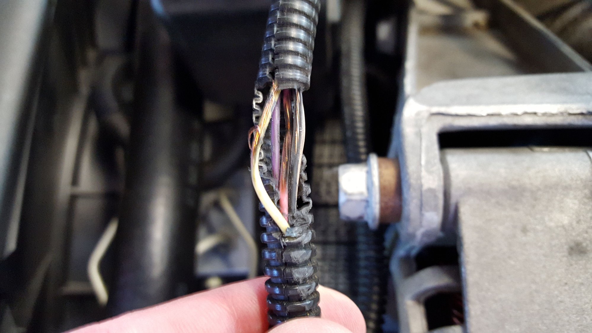

Well I think I found the culprit rather quickly and a lot of pure luck! I checked all the grounds they all looked fine, I had some brake clean so I thought I pull the MAF off and clean it out. As I was pulling the connector out, I noticed a burnt spot on the MAF sensor lead. Turns out when I put the CAI on I moved the MAF from the front part of the engine shroud to right in front of the TB. Well that freed up a foot or so of cable that I tucked under the driver side engine cover, over time that worked it's way down and at times laid against one of the front engine header tubes and melted the cover and part of the wiring, I guess that was grounding out against the header thus causing the issue. (I THINK).
Does anyone know if I trim an inch or so out of the MAF lead if that will cause any issues? Ohm load etc?? For now I'm going to cut it out, and heat shrink the lead back together and wire tie it off so it does not slip again.
Anyone think this could have been causing my issue??

Seems to have resolved the issue. Man oh man that was pure luck finding that. I was just going to disconnect the MAF but thought what the heck, I'll pull the MAF power lead as well then I noticed the burn through area. All soldered and heat shrink wrapped, car runs like a Vette should run again! One very happy and LUCKY camper. That would have taken quite a while to find otherwise.

cut all the slack you need to out of the harness and resolder your maf wires... it won't cause any trouble and will look much cleaner... glad it was a simple and easy fix
