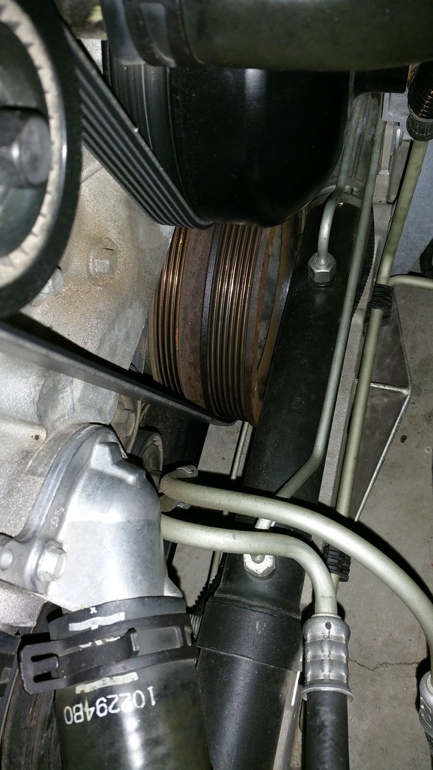

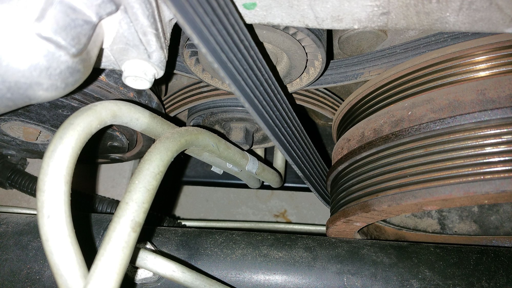

Mine separated Wednesday, I also never saw any wobble.. even looked at it last Saturday. It dropped the AC belt off the back side, the outer pulley ring moved forward a good 1/2" and bumped the steering rack. I was just about to start a couple projects on it and this definitely isn't what I had in mind.
