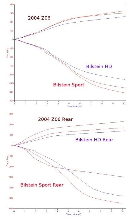

the rear shocks are really what makes the 04 z06 shocks special.
A good combo would be 04z shocks on the rear and billstien sports on the front if you must go new.
Looking at the graph, the sports are nearly identical in the front.
Personally, I would never have different manufacturers shocks on the same car. The Bilsteins may have similar dyno characteristics to the Z06 but they will age differently over time which may make the car tricky to handle. Also, they may not react the same way to brisk maneuvers, temperature swings, etc. Stick with the complete set of whatever shock you decide to go with. They were designed to work as a set. Just my two cents.
