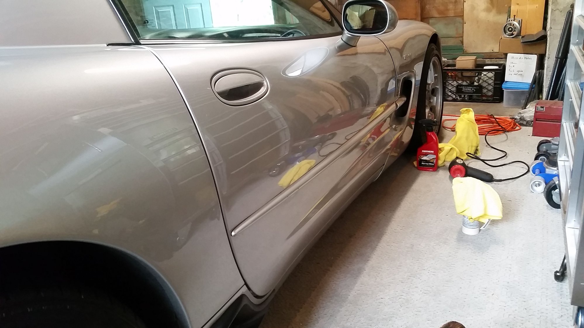

Before
After
Love the look n how smooth n clean the body looks now ..

What technique did you use to take them off? I've thought about doing the same, just not sure how to tackle it. Thanks

I used a heat gun to soften up the double sided tape that holds them on and I used a 2 foot piece of fishing line to slip behind without scratching the paint ... in a saw type motion I went back n fourth cutting them away from the car without pulling on the molding n causing a crease .. I can easily get new tape n put them back on the car or sell if anyone wanted them .... as far as for chemicals I used goo gone to help soften the left over glue and I have a mild grade compound to get the aged caked up dirt and then a quick detail spray to make her pretty again .....
