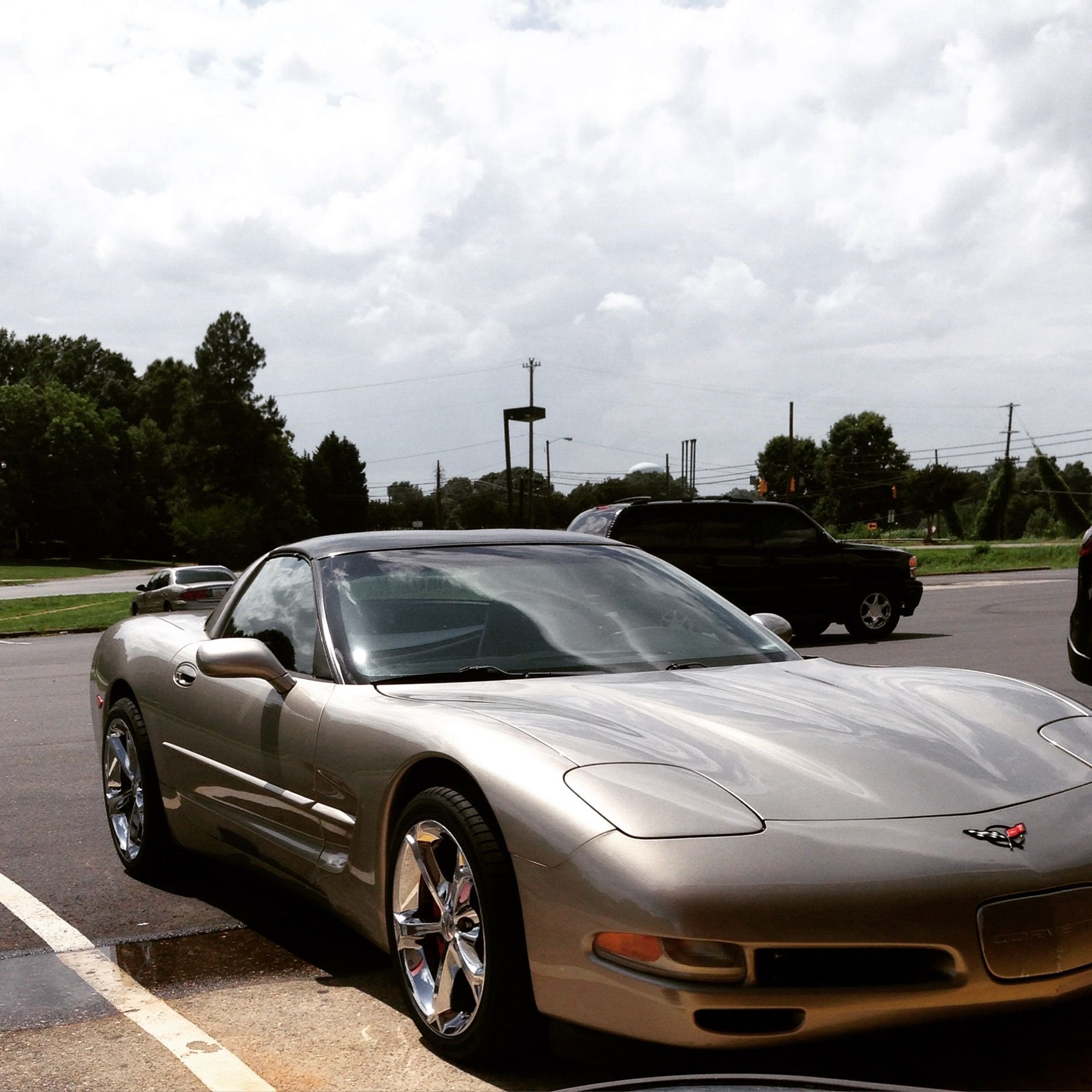

Common Misconception: "The Z06/GS wheels stick out so far!!"
My opinion: It looks aggressive! (It will sling gravels and tire shine though so that's a downside) It isn't a huge amount sticking out... Everyone makes it out to seem like they stick out an inch or 2 and THEY DO NOT. They stick out less than an inch in both the front and the rear.
**This isn't a good picture but you can kind of see it**
I love the addition of these wheels I have gotten so many compliments and only one negative opinion from a C6 owner (His car was as stock as stock gets.. Nothing wrong with that but still) And you have to love the 325's in the rear! (I DO NOT scrub in the front or the rear with these tires 275/35r18 325/30r19)

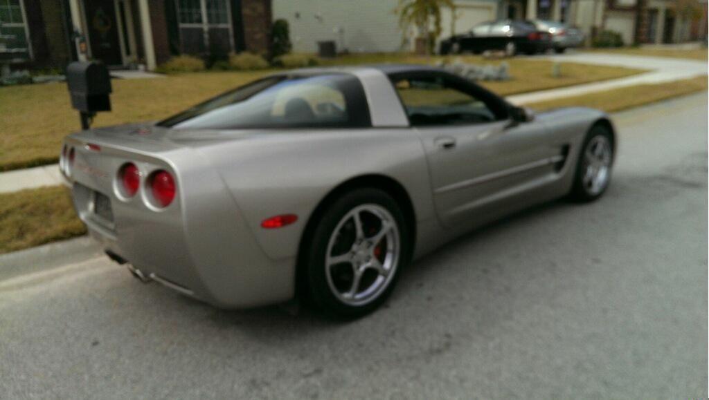

**SO STOCK Old Picture**
