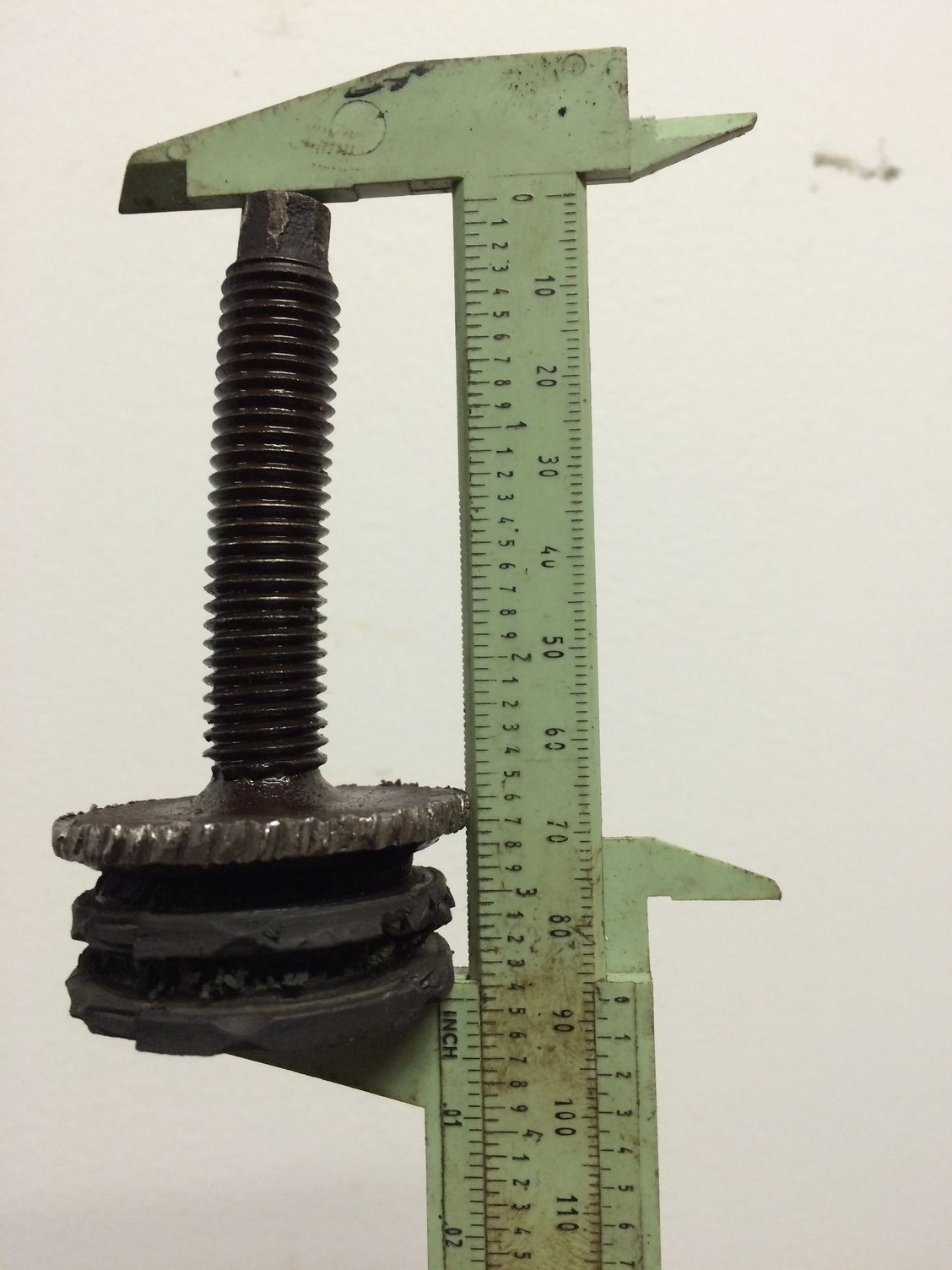

I feel your pain bro! This adjuster required PB Blaster for three days, alittle heat and a 10 in pipe wrench. I don't think I bent the adjuster on removal, I was firm but careful. Other members have reported bent adjuster bolts as well. Only makes removal that much harder!
Use only as much heat as required. The inserts are for the adjusters are installed with an adhesive, not sure how sensitive to heat they may be. To much heat and the adhesive may become brittle casusing failure and the insert will spin in the hole of the spring.
Clean the threads of the adjuster as far as you can,before you start, with a die. I did have the spring removed when replacing adjusters.
I replaced with used stock adjusters from a Vettenuts.
Good Luck
