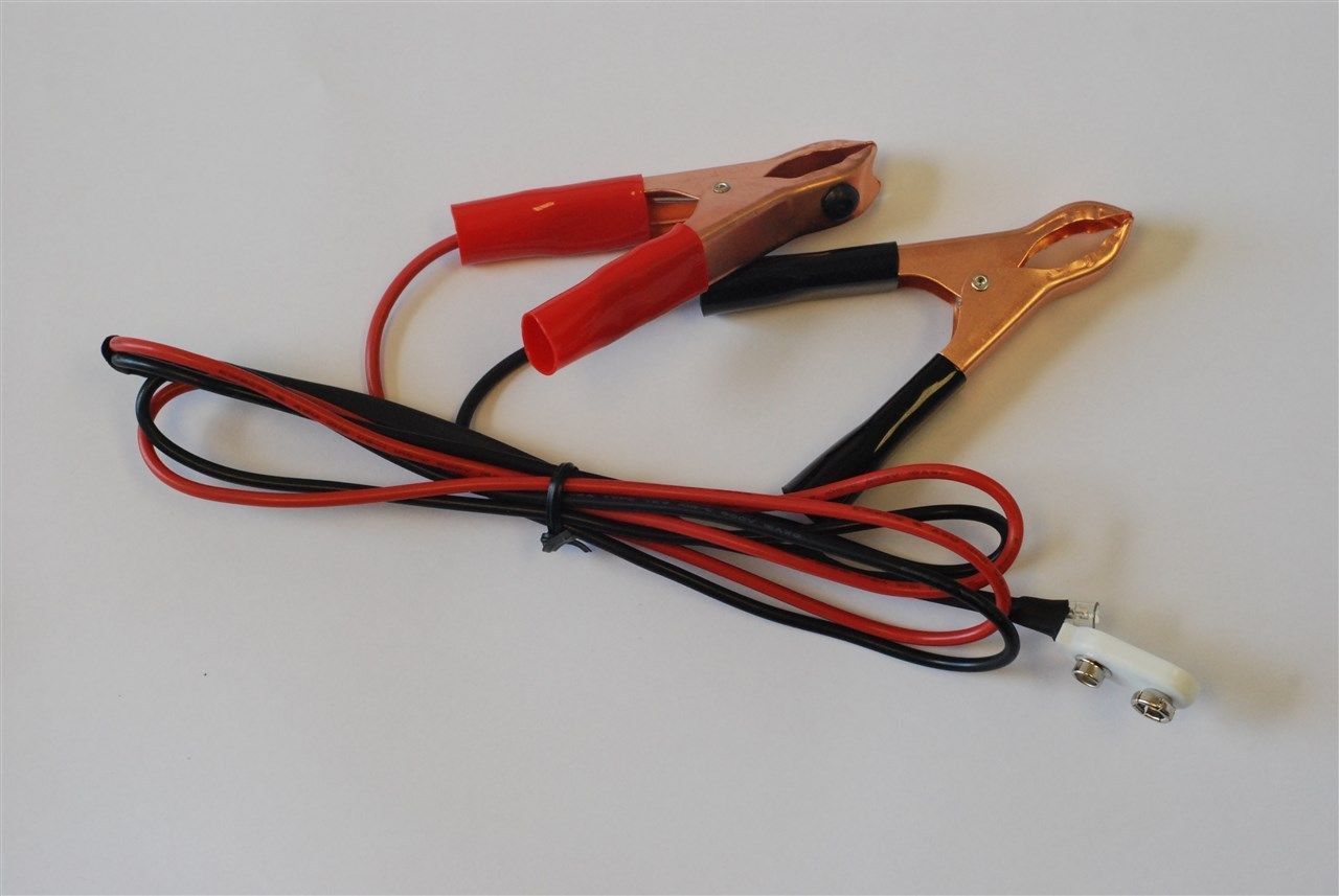

I went out late last night and noticed the red led light does flash on my radio. Thus, I'm assuming the radio is enabled. My battery is not dead yet but I know it's coming up in the near future. I also have a Lisle Memory Saver. It basically has two battery clips, (red+ and black-) Once connected to the terminals, a light on the end of the terminals lights up, at this point you can connect a 9V battery (square ones). According to instructions, you can remove the battery cables without locking your radio losing other memory devices on the car. I haven't tried it yet, and it seems kinda odd that a 9V battery would keep the memory alive on a car? Has anyone tried this method? I appreciate the information on unlocking the radio. My other option is to just buy another radio and upgrade. Here is picture of the memory saver:

That 9 VDC battery wil work IF,, you dont have any loads on the system.. Thats TOUGH to do on a C5.
Why dont you just do this:
Get a set of JUMPER CABLES and jump the battery of another car to the B+ connection on the Engine Fuse Box and Chassis ground;

I have seen some of the 9v "memory savers" advertised in the various Corvette accessory mags and they say not to use them on a C5. There is enough voltage drain in these cars that will very quickly kill the little battery and 9v may not even be enough to retain the settings.
Besides the jumper cables, a jumper box can also be used. And you can leave either one connected for a long time.

I've heard a 9V battery will work but I'd think the car would have to be in sleep mode to use it. So you'd have to open the hood and close the doors and then let it sit at least 20 minutes without disturbing it. I'd connect the clips to the post Bill shows and the engine block because the likelyhood of maintaining a good connection on the battery cables while you're removing them is slim to nil.
If you want to know it'll be OK for sure then jumper another battery like Bill suggests and make damn sure you don't touch the positive battery cable to the negative cable or to ground. It really wouldn't be too bad because there is a lot of plastic around the battery.
