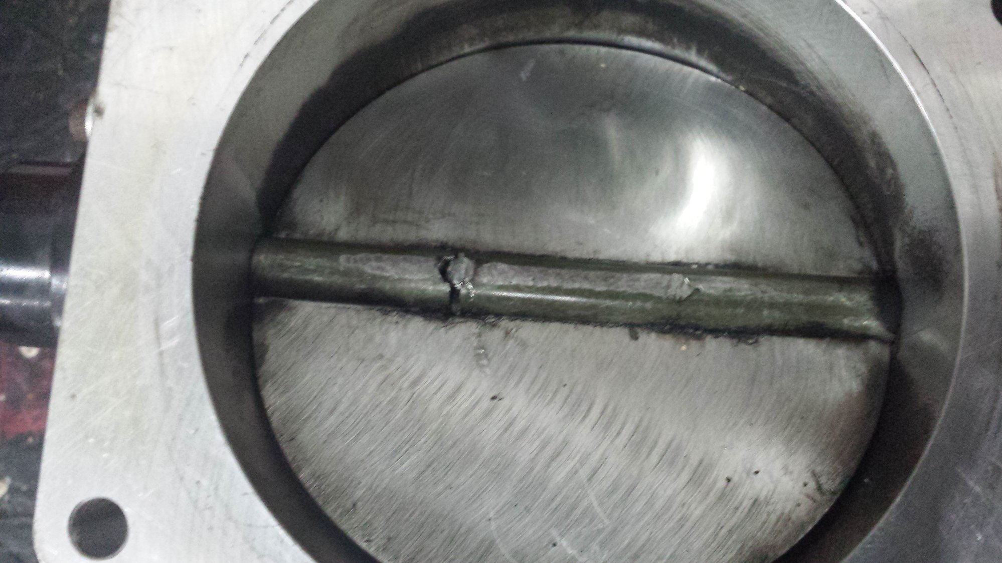

Ended up finding the problem was mechanical and not electrical. Throttle body shaft was broken in two.
Overlooked this.
The tb. Is 100mm. But shaft looks like a stock piece. I pulled it out welded it up for a temporary fix until I find a new shaft.

That shaft looks HORRIBLE! I bet it was binding when going to the idle position and setting off the Accelerator vs Throttle Position Sensor position voltage variation. That will cause REP.
Hey, when you get the new stuff in installed, take the old stuff apart and take some pictures. What did the front of the shaft look like? Looks like someone was trying to thin it out for more air flow. I'm hesitant on doing a lot of grinding on the shaft when I port TBs. Its for that very reason.
