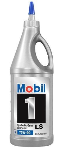

Personally I'm not brand loyal. The main thing with the crankcase oil is you want to use a full synthetic. 5w-30 is fine ... some guys go thinner/thicker depending on usage characteristics and latitude. You will hear a few guys claiming dino oil is fine for the C5 citing that the Camaros and LS trucks don't call for full syn. But the difference is the Corvettes tend to run hotter and at least in my experience, my engine burns through dino oil much faster than syn.
As for transmission, I used to get an occasional grind from 3-4 on hard shifts, so at the suggestion of local mechanic I drained out the Dex and refilled with Penzoil Synchromesh. The grind went away, and shifts are noticeably smoother now soooo I'm a believer
For the diff, if you get the M1 75-90 with the "LS" designation, you don't need to buy the additive. It's already in there.

Would it hurt to also add the additive? I know how critical it was in my mustang to add it even if the gear lube had the modifiers in it already.
The additive is a friction modifier, so I don't think more is necessarily better. I do know for a fact that with the M1 75w-90 LS gear oil, my differential engages both wheels when it should.

I would try it without the additive if the lube oil says for LS. Many people have had good luck without putting in the additive.
However, on my '96 Impala SS even though the lube said LS, the differential chattered bad. I sucked a little bit out of the fill hole and put the additive in. No more chatter.
The short answer is yes. Use the lube from the bottle and then take it to a parking lot and do some slow figure 8's with the car. This will work the new oil into the clutches. If you start to get chatter add a bit of additive, but I wouldn't use the whole bottle.
Too much additive will eliminate the limited slip capability of the differential so approach this carefully.

I agree. Do not add LS additive unless you need it. I know this for a fact. I had added additive to GM LS diff fluid even though I didn't need it. It basically caused the limited slip to no longer function correctly and on hot days, the fluid would spit out the top vent even though the level was correct. Changed out the fluid and went with Castrol Synthetic with no additive. Problem solved. No chatter or any other issues.

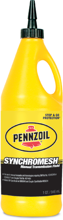

Research tells me I can run DEX VI in my 02 transmission since it is not the one with the paper rings... guess that changed in the 01+ models... is that not true?
Ditch the Dex
use this ...

The Amsoil actually is a synthetic ATF.
The mobil1 gear oil does not have additives in it. IIRC, the GM 88862624 is the only diff fluid that comes with the additive already in it.
Incorrect, the "LS" designation on their gear oil specifically refers to the limited slip additive.
