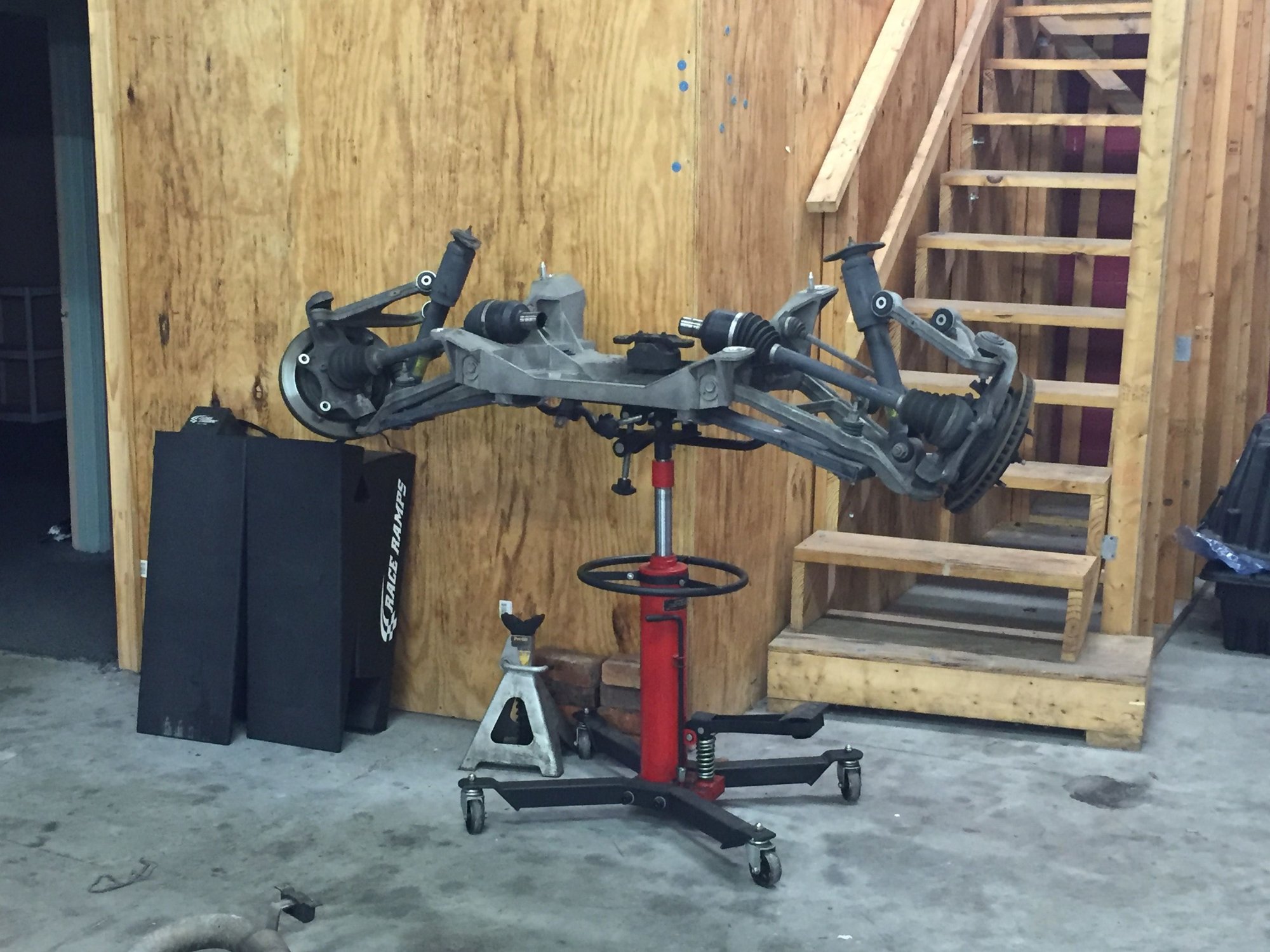

Old Nov 14, 2015 | 06:08 PM
ssmoke-u's Avatar
ssmoke-u
Joined: Jul 2004
Posts: 418
Likes: 26
From: Hilton Head, South Carolina
These are some of the pics I have which gives you an idea of the progression of things
