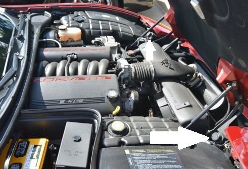

You seem to be having some problems finding the manual headlight *****. Here's a pic to assist. Counter clockwise to open. Clockwise to close. Takes a lot of turns to move the headlights a little. Sometimes headlights get stuck. Turn the **** on the offending headlight a little to "loosen" it then see if it will open normally with your switch. If not, then you might have an electrical gremlin to trace down. GL and keep us updated.
Thank you for your input and the picture. I did find the ****. It has a rubber cap. Do I remove this rubber cap and turn something under the cap or just turn the rubber cap itself?

Just turn the **** as shown in the picture. Good luck, we'll figure out the issue with as little money as possible.

My manual **** has rubber cover with the following message imprinted on it: "REMOVE FOR MANUAL OPERATION". I tried removing the cover but found no way to turn the ****. I put the cover back on and turned the rubber cover a few turns, counter clockwise. I raised the head light about 1/8 inch and tried the light. Both headlights popped up! I tried the lights on and off quite a few times and everything seams to be working fine.

These ol' headlights are giving you fits...heh. In post #8, dadaroo told you it was probably the bumper stops. Over time, the bumper stops get worn or worn out might be a better term. They're simply hard nylon/plastic stops that tell the headlight when to stop trying to open or close. If I remember correctly, there are 4 on each headlight. To see them you have to raise the headlights, then look below them. Two in front and two in back of each headlight. They simply slip on to a metal arm and they are reversible (you can take them off, turn them over and slip them back on). And what do these mysterious bumper stops look like? Here ya go...
I have no idea what happened. Why did it malfunctioned initially? Why is it apparently fixed now? I wonder if the initial problem was a simple bumper stop (whatever that is) that you mentioned earlier (and my mechanic replaced the whole headlight motor assembly to "fix" the problem)? Also why did the cover say to "REMOVE FOR MANUAL OPERATION", when the only apparent way to turn the **** is with the cover not removed? And finally, should I ask my mechanic to check anything out so this won't happen again?
Trying to answer them as you asked them.
Why did it malfunction initally? Probably a worn bumper stop. The motor tightens down too hard and then doesn't have the strength to reopen. When you manually loosened it a little, worked just fine.
Why is it apparently fixed now? Probably just a one time glitch but if it happens again you know what to look for. One of my headlights has this happen occasionally. No problems. I just fix and move on.
"I wonder if the initial problem was a simple bumper stop?" Who knows, maybe. You should have asked here in CF before you took it to the mechanic. We like to do things as inexpensively as possible plus you get to learn about your car.
Lastly, the Remove for Manual Operation. I agree, its a little confusing but all of us told you to just turn the ****. No harm, no foul. You now know to ignore this. And the headlight saga comes to a close......
