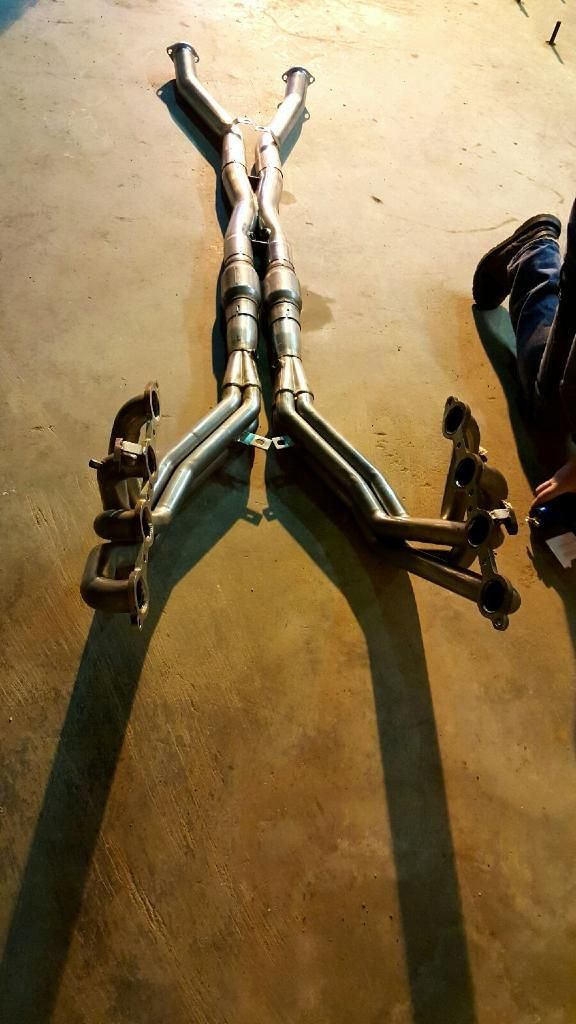

I want to make sure these are legit lg pro headers . Please look close and let me know.

Yes, those are LG Super Pro's.

those look like Lg's to me as well... they are probably an older set, the newer ones do not have the mounting tabs near the collector... I bought mine 5 years ago and they do not have those tabs, so I would say this set has to at least be that old or older... mine do have a tag spot welded to the #2 cylinder primary but then again the older sets may not have had this tag

what is welded in the #6 primary?... I just noticed that but I'm pretty sure they didn't come that way from LG, maybe it's for an egt gauge?... I wouldn't want it there if it isn't needed, especially on a brand new set... and I don't see any clamps but the ones LG supplies aren't the best anyway... I would suggest using some stainless lap band clamps like these instead, http://www.jegs.com/i/Dynomax/289/33272/10002/-1 ... you would need 6 to do the whole system
I thought this was for the AIR set up? Please tell me if im wrong? The more i think about it for $1200 for headers that the owner doesnt seem to know much about it scetching me out more and more. He said his dad ordered them for his 03 vette. But on LG's site they offer the AIR fitting option for 97-2000. So why would he want this for a 03? And he said these are ceramic coated, but on LG's site for the pro LT headers they dont come coated. And a few other things like the ad on craigslist says " custom exhaust set up"? Why the hell would you write that if they are LG pros? Why not write that? And also in the ad it states that these headers can be used for manu different set up's beside the c5 corvette? Really ?? No way they are vehicle specific. Just seems odd. And now someone points out the piece welded on the primary below the AIR fitting. Please guys i need your help on this BIG TIME. If i pass on this deal im not screwing around with used ill just go buy new ARH from slowhawk and get everything done from Don as a package deal.

Mine had that as well. I believe it is to accommodate the early dipstick bolt location which was later moved to the head. Looks like the AIR connections were modified to provide better support. Might have broke off at one time. I cut mine off and weld filled the tube so I didn't care about the AIR connection.

The rear O2 sensor mounts look awfully tight... $1200 for those seems on the high side of OK. I'd rather own them for $1000 at most.

ok that makes sense but it looks kinda sloppy to me compared to the picture of Ed's header... and you're right about the air pipe mounts being reinforced, I forgot about that... the newer ones are reinforced but the older ones were not so the owner probably had those added on, no biggie... I wish LG would offer them without the air pipe mounts for those of us who aren't using them... they also do not appear to be ceramic coated as the owner is stating... you could buy a brand new set of LG's or ARH's for just a few hundred more than what they are asking so if you have a bad gut feeling then I would probably go that route for peace of mind
