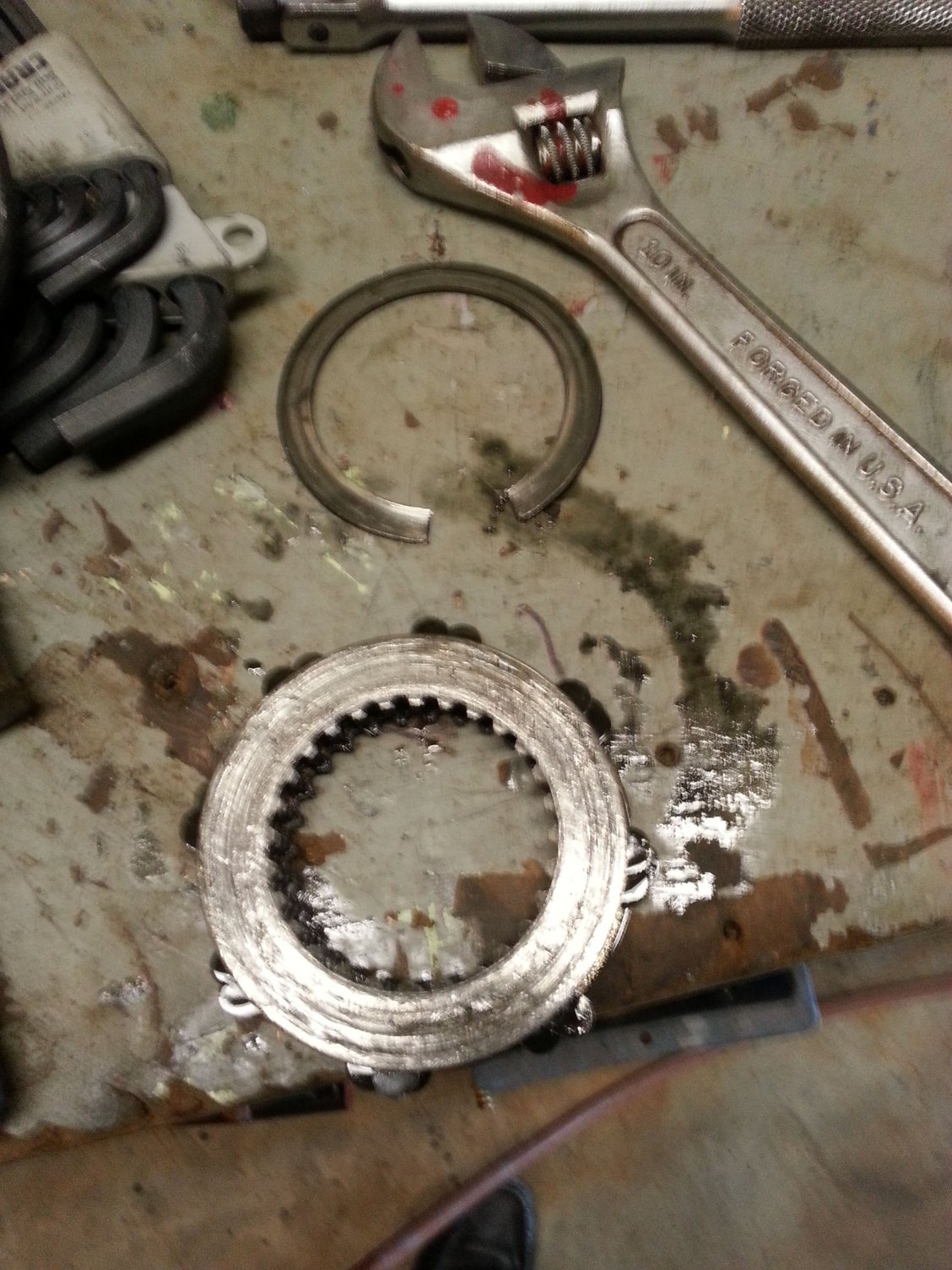

I made a thread that includes some pointers on rebuilding the diff. Unfortunately for me, part of the washer broke off inside the diff and got churned up. In the case of churned up metal, it would be wise to replace all the bearings as well as the gears. Nothing exactly went "BLAMO", LOL, but there was certainly a good possibility that may have happened, and luckily it did not crack the case. DTE makes some upgraded Belleville washers as well as upgraded clutch packs.
https://www.corvetteforum.com/forums...dies-pics.html
