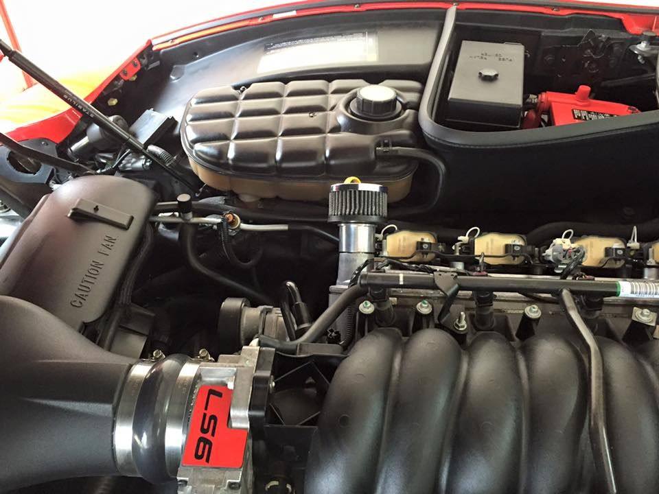

Hello all. So I bought something from a forum member purely because it looks cool and was super cheap. I bought a oil cap breather. I probably done a some research first. But hey it was only $30. I have a 02 Z06 with cam, full exhaust and bolt ons with PCV still in place. So this morning I put it on and drove around for abut 10min and drove fine and no oil splashed or leaked out. Is this safe to use for now? Any real benefits on a NA motor like mine? Also will be getting a catch can soon. Thanks for the help. Here are a few pics.

Well................. GM Sealed the PCV System and the oil cap on the cover for a reason. The PCV Valve METERS how much air is induced in and out of the engine around the TB and compensates for that in the tune.
The fresh air for the system comes from the throttle body. The small depression in the mouth of the TB is the hole for the filtered air (after the MAF) to enter the crankcase,, You are now allowing air to enter the crankcase that is unmetered.
When you vent the crankcase (with that cap),, you do a couple of things. You change the flow of fresh air in the engine. I do not know how much it hinders the correct flow.
You change the tune by inducing added unmetered air into the engine. How much i don't know off the top of my head.
There is a time to use that rig and thats when you have forced induction.
Looks good, Runs correctly. Pick you poison..

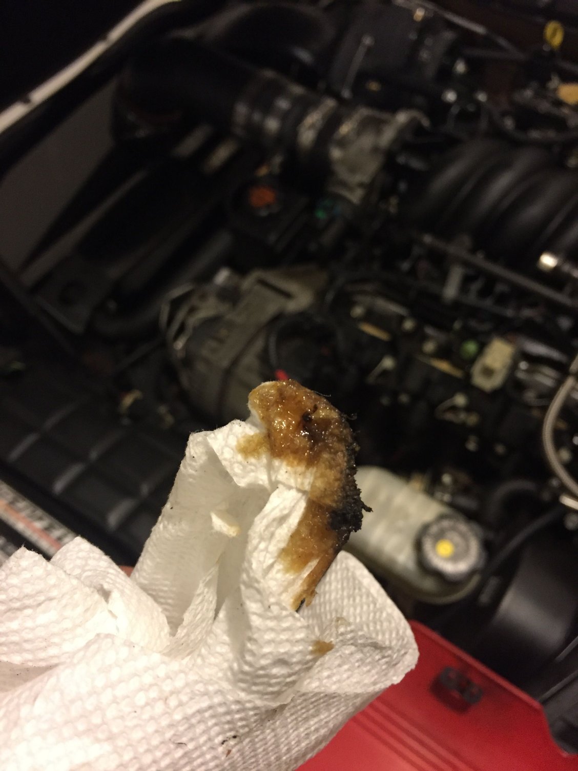

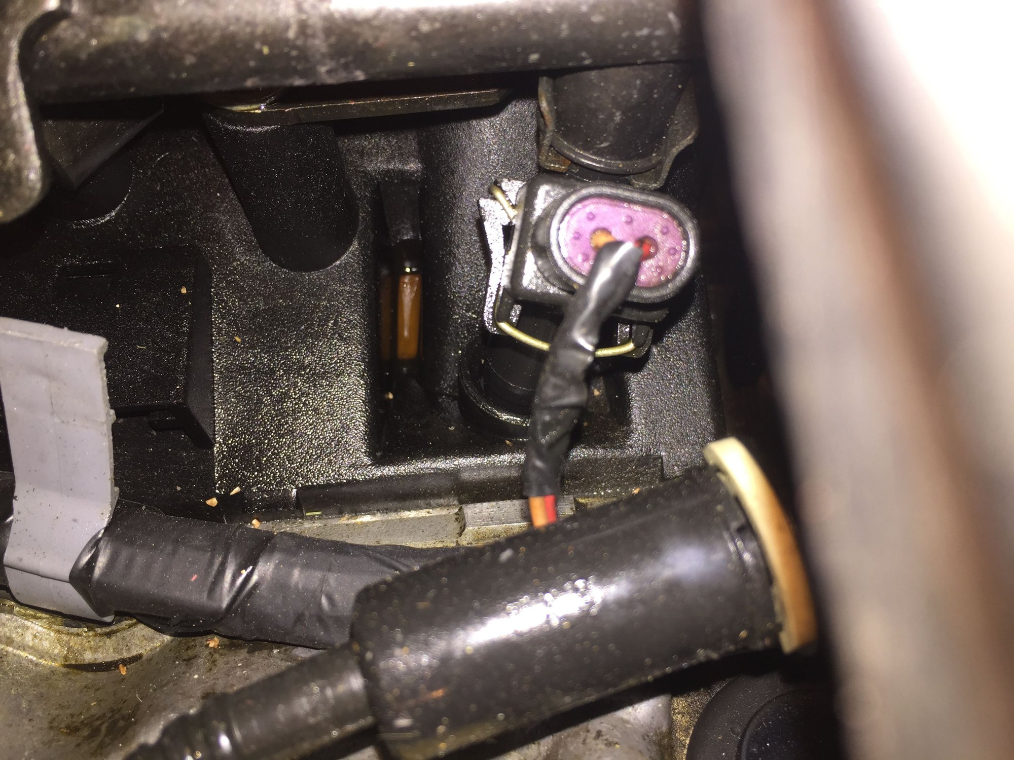

This 01z with ECS 1500 is new to me and noticed fresh oil around the top of the intake manifold by injectors on both sides. I have an oil cap breather could this be the problem? Or am I looking at something else?
